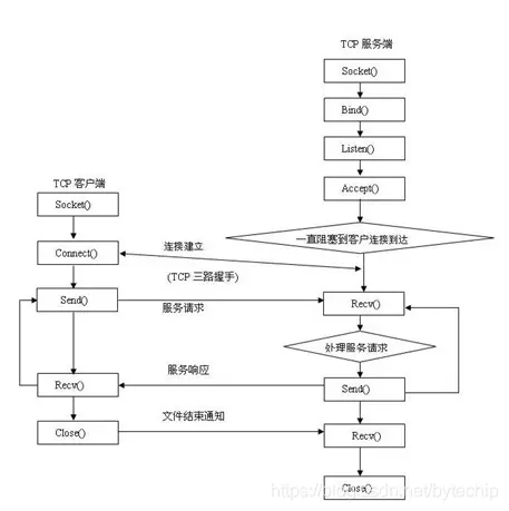

四、TCP服务端
4.1 主要流程
4.1.1 第一步:新建socket
int addr_family = 0;int ip_protocol = 0;addr_family = AF_INET;ip_protocol = IPPROTO_IP;int listen_sock =  socket(addr_family, SOCK_STREAM, ip_protocol);if(listen_sock < 0) {
    ESP_LOGE(TAG, 'Unable to create socket: errno %d', errno);}
4.1.2 第二步:配置服务器信息
#define TCP_PORT             3333                // TCP服务器端口号struct sockaddr_in dest_addr;dest_addr.sin_family = AF_INET;dest_addr.sin_addr.s_addr = htonl(INADDR_ANY);dest_addr.sin_port = htons(TCP_PORT);
4.1.3 第三步:绑定地址
int err = bind(listen_sock, (struct sockaddr *)&dest_addr, sizeof(dest_addr));if(err != 0) {
    ESP_LOGE(TAG, 'Socket unable to bind: errno %d', errno);
    ESP_LOGE(TAG, 'IPPROTO: %d', addr_family);
    close(listen_sock);}ESP_LOGI(TAG, 'Socket bound, port %d', PORT);
4.1.4 第四步:开始监听
err = listen(listen_sock, 1);    // 这里为啥是1,网上大多数是5if(err != 0) {
    ESP_LOGE(TAG, 'Error occurred during listen: errno %d', errno);
4.1.5 第五步:等待客户端连接
while(1){
    struct sockaddr_in6 source_addr; // Large enough for both IPv4 or IPv6
    uint addr_len = sizeof(source_addr);
    int connect_sock = accept(listen_sock, (struct sockaddr *)&source_addr, &addr_len);
    if(connect_sock < 0)
        ESP_LOGE(TAG, 'Unable to accept connection: errno %d', errno);
        close(listen_sock);
4.1.6 第六步:接收数据
int len;char rx_buffer[128];while(1){
    memset(rx_buffer, 0, sizeof(rx_buffer));    // 清空缓存
    len = recv(connect_sock, rx_buffer, sizeof(rx_buffer), 0);  // 读取接收数据
    if(len < 0)
        ESP_LOGE(TAG, 'Error occurred during receiving: errno %d', errno);
    else if (len == 0)
        ESP_LOGW(TAG, 'Connection closed');
    else
        ESP_LOGI(TAG, 'Received %d bytes: %s', len, rx_buffer);
4.1.7 第七步:发送数据
send(connect_socket, rx_buffer, sizeof(rx_buffer, 0);
