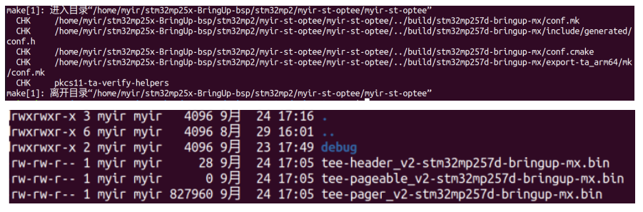

在上一章节中提到stm32mp257d-bringup-mx-resmem.dtsi 和 stm32mp257d-bringup-mx-rif.dtsi 直接使用 SourceCode 压缩包 Optee-os 目录中的文件,如果还未拷贝,需要将其通过软链接或者拷贝的方式放到stm32mp25x-BringUp-bsp/myir-st-optee/myir-st-optee/core/arch/arm/dts/目录下。
编译 Optee
myir@myir-vm: cd /home/myir/stm32mp25x-BringUp-bsp/myir-st-optee/myir-st-optee
myir@myir-vm:~/stm32mp25x-BringUp-bsp/myir-st-optee/myir-st-optee$ source /opt/st/myd-ld25x/4.2.4-snapshot/environment-setup-cortexa35-ostl-linux
myir@myir-vm:~/stm32mp25x-BringUp-bsp/myir-st-optee/myir-st-optee$ export FIP_DEPLOYDIR_ROOT=../../FIP_artifacts
myir@myir-vm:~/stm32mp25x-BringUp-bsp/myir-st-optee/myir-st-optee$ export FWDDR_DIR=../../stm32mp-ddr-phy-A2022.11-r0/stm32mp-ddr-phy-A2022.11
myir@myir-vm:~/stm32mp25x-BringUp-bsp/myir-st-optee/myir-st-optee$ make -f $PWD/../Makefile.sdk DEPLOYDIR=$FIP_DEPLOYDIR_ROOT/optee CFG_EMBED_DTB_SOURCE_FILE=stm32mp257d-bringup-mx optee
注:已将上述Optee单独编译的命令存放在/home/myir/stm32mp25x-BringUp-bsp/myir-st-optee/myir-st-optee/build.sh
可以看到已经生成了bin文件
