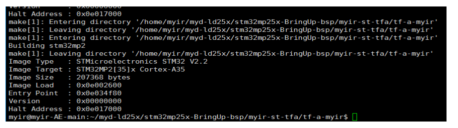

以上已完成配置,就可以进行TF-A的单独编译。
myir@myir-vm: cd /home/myir/stm32mp25x-BringUp-bsp/myir-st-tfa/tf-a-myir
myir@myir-vm:~/stm32mp25x-BringUp-bsp/myir-st-tfa/tf-a-myir$ source /opt/st/myd-ld25x/4.2.4-snapshot/environment-setup-cortexa35-ostl-linux
myir@myir-vm:~/stm32mp25x-BringUp-bsp/myir-st-tfa/tf-a-myir$ export FIP_DEPLOYDIR_ROOT=../../FIP_artifacts
myir@myir-vm:~/stm32mp25x-BringUp-bsp/myir-st-tfa/tf-a-myir$ export FWDDR_DIR=../../stm32mp-ddr-phy-A2022.11-r0/stm32mp-ddr-phy-A2022.11
myir@myir-vm:~/stm32mp25x-BringUp-bsp/myir-st-tfa/tf-a-myir$  make -f $PWD/../Makefile.sdk DEPLOYDIR=$FIP_DEPLOYDIR_ROOT/arm-trusted-firmware TF_A_CONFIG='optee-emmc usb' TF_A_DEVICETREE=stm32mp257d-bringup-mx ELF_DEBUG_ENABLE='1' stm32 metadata
 注:已将上述TF-A单独编译的命令存放在/home/myir/stm32mp25x-BringUp-bsp/myir-st-tfa/tf-a-myir/build.sh
编译完成:
