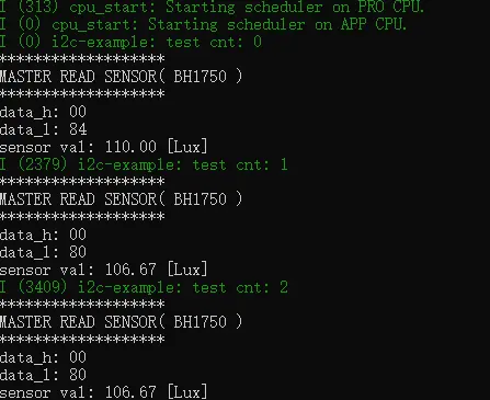

        } else if (ret == ESP_OK) {
            printf('*******************n');
            printf('MASTER READ SENSOR( BH1750 )n');
            printf('data_h: %02xn', sensor_data_h);
            printf('data_l: %02xn', sensor_data_l);
            printf('sensor val: %.02f [Lux]n', (sensor_data_h << 8 | sensor_data_l) / 1.2);
        } else {
            ESP_LOGW(TAG, '%s: No ack, sensor not connected...skip...', esp_err_to_name(ret));
        xSemaphoreGive(print_mux);
        vTaskDelay(1000 / portTICK_RATE_MS);
    vSemaphoreDelete(print_mux);
    vTaskDelete(NULL);
void app_main(void)
    print_mux = xSemaphoreCreateMutex();
    ESP_ERROR_CHECK(I2C_Init());
    xTaskCreate(i2c_test_task, 'i2c_test_task_0', 1024 * 2, NULL, 10, NULL);
查看打印:
