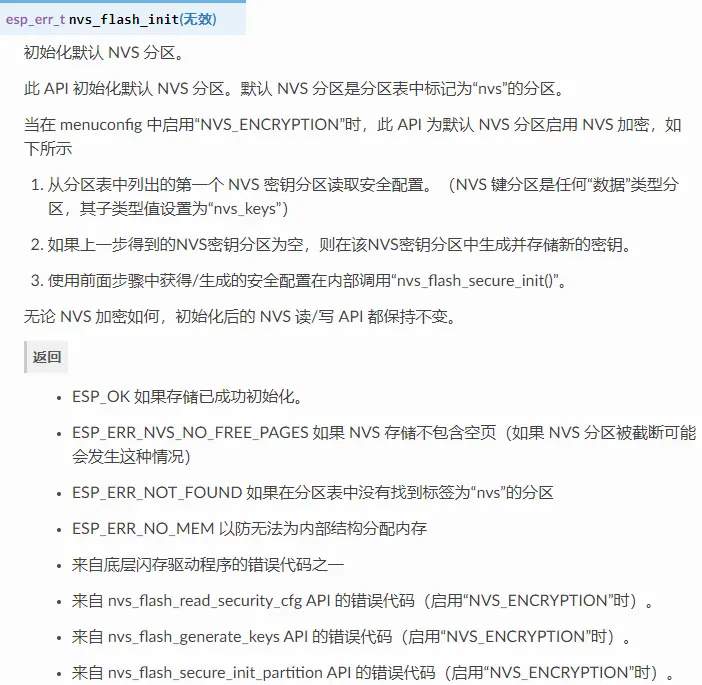

2.1 nvs_flash_init

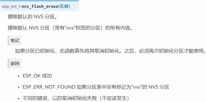

2.2 nvs_flash_erase

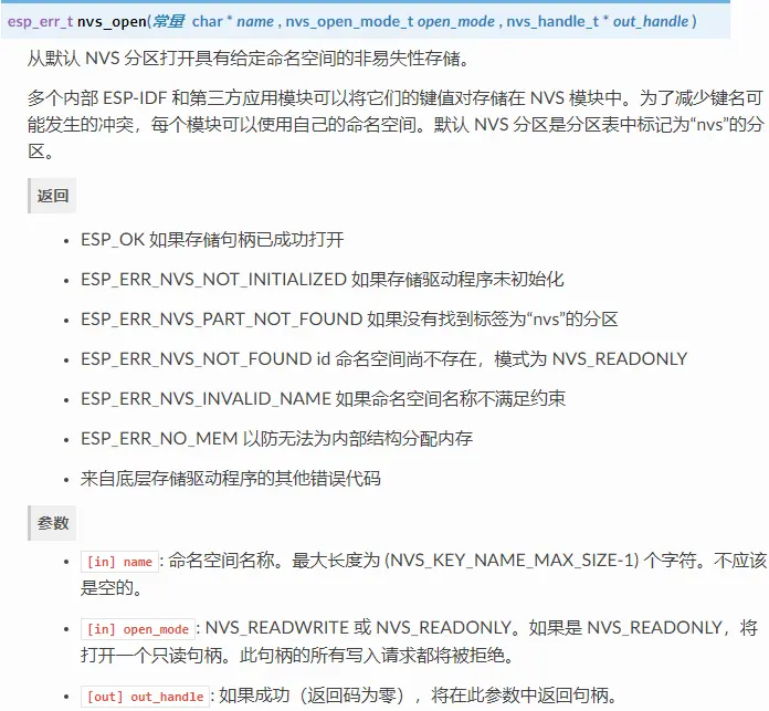

2.3 nvs_open

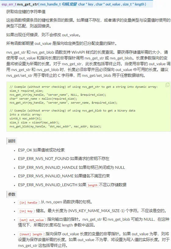

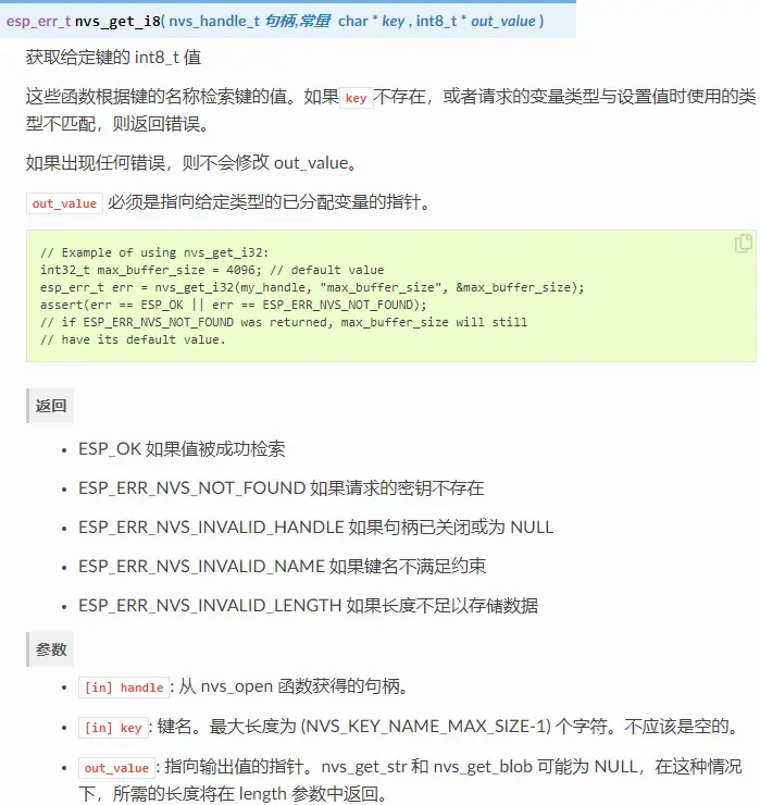

2.4 读取函数
esp_err_t nvs_get_i8  (nvs_handle_t handle, const char* key, int8_t* out_value);
esp_err_t nvs_get_u8  (nvs_handle_t handle, const char* key, uint8_t* out_value);
esp_err_t nvs_get_i16 (nvs_handle_t handle, const char* key, int16_t* out_value);
esp_err_t nvs_get_u16 (nvs_handle_t handle, const char* key, uint16_t* out_value);
esp_err_t nvs_get_i32 (nvs_handle_t handle, const char* key, int32_t* out_value);
esp_err_t nvs_get_u32 (nvs_handle_t handle, const char* key, uint32_t* out_value);
esp_err_t nvs_get_i64 (nvs_handle_t handle, const char* key, int64_t* out_value);
esp_err_t nvs_get_u64 (nvs_handle_t handle, const char* key, uint64_t* out_value);
//这两个的长度需要特殊操作

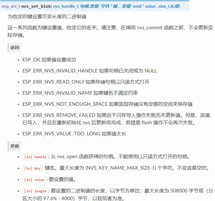

esp_err_t nvs_get_str (nvs_handle_t handle, const char* key, char* out_value, size_t* length);
esp_err_t nvs_get_blob(nvs_handle_t handle, const char* key, void* out_value, size_t* length);

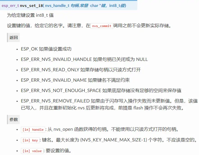

2.5 写入函数
esp_err_t nvs_set_i8  (nvs_handle_t handle, const char* key, int8_t value);
esp_err_t nvs_set_u8  (nvs_handle_t handle, const char* key, uint8_t value);
esp_err_t nvs_set_i16 (nvs_handle_t handle, const char* key, int16_t value);
esp_err_t nvs_set_u16 (nvs_handle_t handle, const char* key, uint16_t value);
esp_err_t nvs_set_i32 (nvs_handle_t handle, const char* key, int32_t value);
esp_err_t nvs_set_u32 (nvs_handle_t handle, const char* key, uint32_t value);
esp_err_t nvs_set_i64 (nvs_handle_t handle, const char* key, int64_t value);
esp_err_t nvs_set_u64 (nvs_handle_t handle, const char* key, uint64_t value);
esp_err_t nvs_set_str (nvs_handle_t handle, const char* key, const char* value);
//用来存储大二进制数据的函数(比如说结构体)
esp_err_t nvs_set_blob(nvs_handle_t handle, const char* key, const void* value, size_t length);

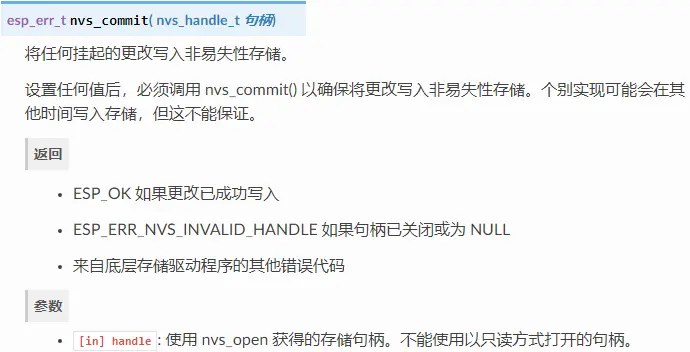

2.6 nvs_commit

2. 初始化NVS Flash
使用 nvs_flash_init(),如果 Flash 满了或者希望清空原来的数据,就使用 nvs_flash_erase() 清空。
3. 打开NVS,配置句柄
对NVS空间进行操作的时候,是使用句柄实现的。
同时,为了尽可能减少键值对的冲突,NVS引入了命名空间的概念,不同命名空间下的key捕获产生冲突。
同时也要在这里配置对NVS空间进行操作的权限,分为读和读写两种。
nvs_handle_t handle;nvs_open('namespace1', NVS_READWRITE, &handle);
4. 读写操作
按照不同的数据类型,对数据进行get和set操作
调用中使用nvs_get_*,nvs_set_*和nvs_commit()功能函数。

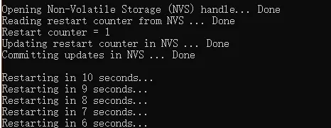

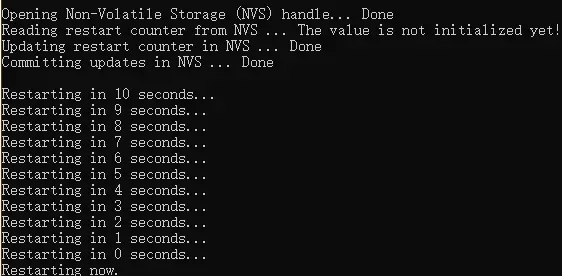

4.1 单变量读写
使用 esp-idfexamplesstoragenvs_rw_value 中的例程

查看打印:
