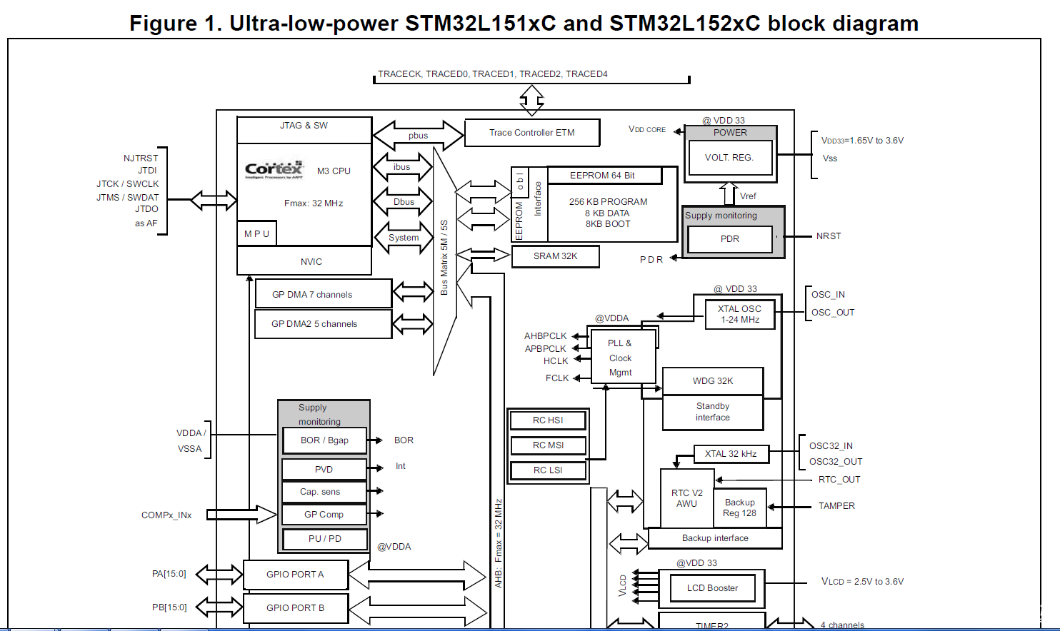

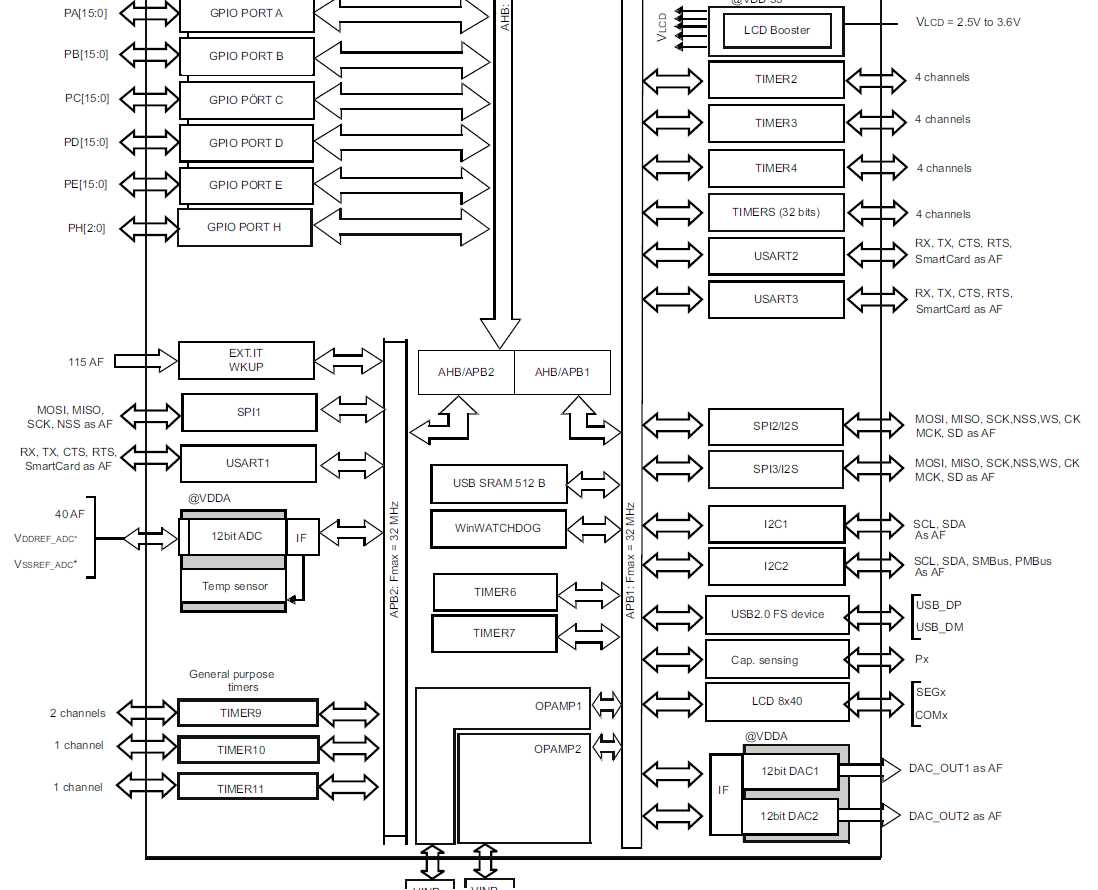

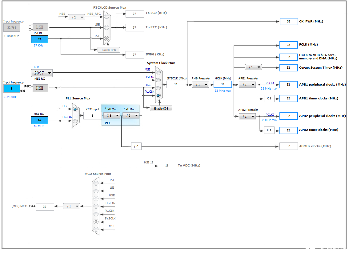

RCC:Reset and Clock Control,复位与时钟控制系统。系统复位有三种:系统复位、电源复位、RTC domain复位。本文重点详解Clock Control部分。下面看下STM32L152芯片的时钟框图和cubeMX软件中的时钟框图。

void SystemClock_Config(void)
RCC_OscInitTypeDef RCC_OscInitStruct;
RCC_ClkInitTypeDef RCC_ClkInitStruct;
RCC_PeriphCLKInitTypeDef PeriphClkInit;
/**Configure the main internal regulator output voltage
__HAL_PWR_VOLTAGESCALING_CONFIG(PWR_REGULATOR_VOLTAGE_SCALE1);//设置调压器输出电压级别1,用来设置调压器输出电压级别,器件未以最大频率工作,达到性能和功耗平衡
/**Initializes the CPU, AHB and APB busses clocks
RCC_OscInitStruct.OscillatorType = RCC_OSCILLATORTYPE_HSI|RCC_OSCILLATORTYPE_LSI
|RCC_OSCILLATORTYPE_HSE;
RCC_OscInitStruct.HSEState = RCC_HSE_ON;
RCC_OscInitStruct.HSIState = RCC_HSI_ON;
RCC_OscInitStruct.HSICalibrationValue = 16;//HSI时钟16M
RCC_OscInitStruct.LSIState = RCC_LSI_ON;
RCC_OscInitStruct.PLL.PLLState = RCC_PLL_ON;
RCC_OscInitStruct.PLL.PLLSource = RCC_PLLSOURCE_HSE;//PLL时钟源为HSE
RCC_OscInitStruct.PLL.PLLMUL = RCC_PLL_MUL8;//8倍频
RCC_OscInitStruct.PLL.PLLDIV = RCC_PLL_DIV2;//2分频
if (HAL_RCC_OscConfig(&RCC_OscInitStruct) != HAL_OK)//初始化
_Error_Handler(__FILE__, __LINE__);
RCC_ClkInitStruct.ClockType = RCC_CLOCKTYPE_HCLK|RCC_CLOCKTYPE_SYSCLK
|RCC_CLOCKTYPE_PCLK1|RCC_CLOCKTYPE_PCLK2;
RCC_ClkInitStruct.SYSCLKSource = RCC_SYSCLKSOURCE_PLLCLK;
RCC_ClkInitStruct.AHBCLKDivider = RCC_SYSCLK_DIV1;//AHB 1分频
RCC_ClkInitStruct.APB1CLKDivider = RCC_HCLK_DIV1;//APB1 1分频
RCC_ClkInitStruct.APB2CLKDivider = RCC_HCLK_DIV1;//APB2 1分频
if (HAL_RCC_ClockConfig(&RCC_ClkInitStruct, FLASH_LATENCY_1) != HAL_OK)//初始化
PeriphClkInit.PeriphClockSelection = RCC_PERIPHCLK_RTC;
PeriphClkInit.RTCClockSelection = RCC_RTCCLKSOURCE_LSI;//RTC时钟选择LSI
if (HAL_RCCEx_PeriphCLKConfig(&PeriphClkInit) != HAL_OK)
/**Configure the Systick interrupt time
HAL_SYSTICK_Config(HAL_RCC_GetHCLKFreq()/1000);//滴答定时器配置
HAL_SYSTICK_CLKSourceConfig(SYSTICK_CLKSOURCE_HCLK);//滴答定时器选择HCLK 不分频
/* SysTick_IRQn interrupt configuration */
HAL_NVIC_SetPriority(SysTick_IRQn, 0, 0);//滴答定时器中断优先级
