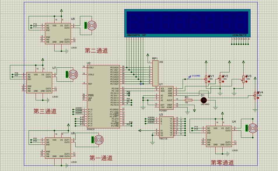

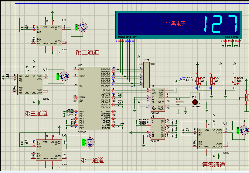

单片机源程序如下:
#include
#include
typedef unsigned char uint8;
typedef unsigned int uint16;
typedef unsigned long uint32;
sbit PWM01=P1^4;
sbit PWM02=P1^5;                                                  //电机1
sbit PWM11=P1^6;
sbit PWM12=P1^7;                                                   //电机2
sbit PWM21=P2^2;
sbit PWM22=P2^3;                                                        //电机3
sbit PWM31=P3^6;
sbit PWM32=P3^7;                                                   //电机4
sbit ADDRC = P1^0;
sbit ADDRB = P1^1;
sbit ADDRA = P1^2;//控制138译码器的三个引脚
uint8 AD_value0 = 0;//AD值
uint8 AD_value1 = 0;//AD值
uint8 AD_value2 = 0;//AD值
uint8 AD_value3 = 0;//AD值
uint8 Top = 255;
uint8 Low = 0;
uint8 between0 = 127;
uint8 between1 = 128;
sbit I2C_SDA = P2^1;
sbit I2C_SCL = P2^0;//I2C通信的两个引脚
bit flag_300ms = 0;//300ms时间标志位
uint8 T0RH = 0;//定时器高8位初值
uint8 T0RL = 0;//定时器低8位初值
//uint8 AD_value = 0;//AD值
uint8 code led_char[] = {0x3f,0x06,0x5b,0x4f,0x66,0x6d,0x7d,0x07,
                                                 0x7f,0x6f,0x77,0x7c,0x39,0x5e,0x79,0x71};//LED段码
void config_timer0(uint8 ms);
uint8 get_ADC_vaule(uint8 chn);
void motor_deal0();
void motor_deal1();
void motor_deal2();
void motor_deal3();
void main()
        config_timer0(1);//初始化通用定时器0,定时1ms
        while(1)
                if(flag_300ms == 1)        //判断300ms时间是否到了
                        flag_300ms = 0;//清除标志位
                        AD_value0 = get_ADC_vaule(0);//读取通道0的AD值
                        AD_value1 = get_ADC_vaule(1);//读取通道0的AD值
                        AD_value2 = get_ADC_vaule(2);//读取通道0的AD值
                        AD_value3 = get_ADC_vaule(3);//读取通道0的AD值
                motor_deal0();
                motor_deal1();
                motor_deal2();
                motor_deal3();
void motor_deal0()
        if(AD_value0 == between0 || AD_value0 == between1)                   //stop
                                PWM01=1;
                                PWM02=1;
                else if(AD_value0>=Low && AD_value0                {
                                PWM01=0;
                                PWM02=1;
                else                                         //反
                        PWM01=1;
                         PWM02=0;
void motor_deal1()
        if(AD_value1 == between0 || AD_value1 == between1)                   //stop
                        PWM11=1;
                        PWM12=1;
        else if(AD_value1>=Low && AD_value1        {
                        PWM11=0;
                        PWM12=1;
        else                                         //反
                PWM11=1;
                 PWM12=0;
void motor_deal2()
        if(AD_value2 == between0 || AD_value2 == between1)                   //stop
                        PWM21=1;
                        PWM22=1;
        else if(AD_value2>=Low && AD_value2        {
                        PWM21=0;
                        PWM22=1;
        else                                         //反
                PWM21=1;
                 PWM22=0;
void motor_deal3()
        if(AD_value3 == between0 || AD_value3 == between1)                   //stop
                        PWM31=1;
                        PWM32=1;
        else if(AD_value3>=Low && AD_value3        {
                        PWM31=0;
                        PWM32=1;
        else                                         //反
                PWM31=1;
                 PWM32=0;
void I2C_delay()//I2C延时函数
        _nop_();
        _nop_();
        _nop_();
        _nop_();
void I2C_start()//I2C起始信号
        I2C_SDA = 1;
        I2C_SCL = 1;
        I2C_delay();
        I2C_SDA = 0;
        I2C_delay();
        I2C_SCL = 0;
        I2C_delay();
void I2C_stop()//I2C停止信号
        I2C_SDA = 0;
        I2C_SCL = 0;
        I2C_delay();
        I2C_SCL = 1;
        I2C_delay();
        I2C_SDA = 1;
        I2C_delay();
bit I2C_write(uint8 dat)//I2C写一个字节
        bit ack = 0;
[1] [2]
