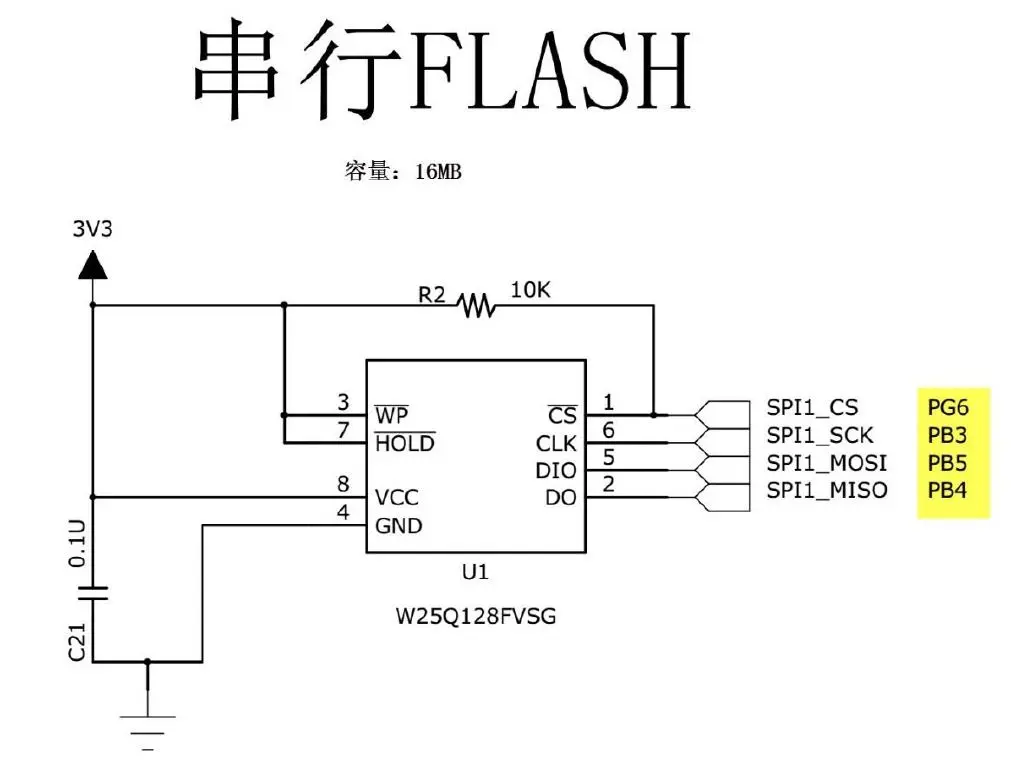

/* Private typedef -----------------------------------------------------------*/
//#define  sFLASH_ID                       0xEF3015     //W25X16
//#define  sFLASH_ID                       0xEF4015     //W25Q16
//#define  sFLASH_ID                        0XEF4017     //W25Q64
define  sFLASH_ID                       0XEF4018     //W25Q128
//#define SPI_FLASH_PageSize            4096
define SPI_FLASH_PageSize              256
define SPI_FLASH_PerWritePageSize      256
/* Private define ------------------------------------------------------------/

/*SPI接口定义-开头****************************/
define FLASH_SPI                           SPI1
define FLASH_SPI_CLK                       RCC_APB2Periph_SPI1
define FLASH_SPI_CLK_INIT                  RCC_APB2PeriphClockCmd
define FLASH_SPI_SCK_PIN                   GPIO_Pin_3
define FLASH_SPI_SCK_GPIO_PORT             GPIOB
define FLASH_SPI_SCK_GPIO_CLK              RCC_AHB1Periph_GPIOB
define FLASH_SPI_SCK_PINSOURCE             GPIO_PinSource3
define FLASH_SPI_SCK_AF                    GPIO_AF_SPI1
define FLASH_SPI_MISO_PIN                  GPIO_Pin_4
define FLASH_SPI_MISO_GPIO_PORT            GPIOB
define FLASH_SPI_MISO_GPIO_CLK             RCC_AHB1Periph_GPIOB
define FLASH_SPI_MISO_PINSOURCE            GPIO_PinSource4
define FLASH_SPI_MISO_AF                   GPIO_AF_SPI1
define FLASH_SPI_MOSI_PIN                  GPIO_Pin_5
define FLASH_SPI_MOSI_GPIO_PORT            GPIOB
define FLASH_SPI_MOSI_GPIO_CLK             RCC_AHB1Periph_GPIOB
define FLASH_SPI_MOSI_PINSOURCE            GPIO_PinSource5
define FLASH_SPI_MOSI_AF                   GPIO_AF_SPI1
define FLASH_CS_PIN                        GPIO_Pin_6
define FLASH_CS_GPIO_PORT                  GPIOG
define FLASH_CS_GPIO_CLK                   RCC_AHB1Periph_GPIOG
define SPI_FLASH_CS_LOW()      {FLASH_CS_GPIO_PORT->BSRRH=FLASH_CS_PIN;}
define SPI_FLASH_CS_HIGH()     {FLASH_CS_GPIO_PORT->BSRRL=FLASH_CS_PIN;}
/*SPI接口定义-结尾****************************/

  • @brief  SPI_FLASH初始化
  • @param  无
  • @retval 无
    void SPI_FLASH_Init(void)
    SPI_InitTypeDef  SPI_InitStructure;
    GPIO_InitTypeDef GPIO_InitStructure;
/* 使能 FLASH_SPI 及GPIO 时钟 /
/!< SPI_FLASH_SPI_CS_GPIO, SPI_FLASH_SPI_MOSI_GPIO,
SPI_FLASH_SPI_MISO_GPIO,SPI_FLASH_SPI_SCK_GPIO 时钟使能 */
RCC_AHB1PeriphClockCmd (FLASH_SPI_SCK_GPIO_CLK | FLASH_SPI_MISO_GPIO_CLK|FLASH_SPI_MOSI_GPIO_CLK|FLASH_CS_GPIO_CLK, ENABLE);
/*!< SPI_FLASH_SPI 时钟使能 */
FLASH_SPI_CLK_INIT(FLASH_SPI_CLK, ENABLE);
//设置引脚复用
GPIO_PinAFConfig(FLASH_SPI_SCK_GPIO_PORT,FLASH_SPI_SCK_PINSOURCE,FLASH_SPI_SCK_AF);
GPIO_PinAFConfig(FLASH_SPI_MISO_GPIO_PORT,FLASH_SPI_MISO_PINSOURCE,FLASH_SPI_MISO_AF);
GPIO_PinAFConfig(FLASH_SPI_MOSI_GPIO_PORT,FLASH_SPI_MOSI_PINSOURCE,FLASH_SPI_MOSI_AF);
/*!< 配置 SPI_FLASH_SPI 引脚: SCK */
GPIO_InitStructure.GPIO_Pin = FLASH_SPI_SCK_PIN;
GPIO_InitStructure.GPIO_Speed = GPIO_Speed_50MHz;
GPIO_InitStructure.GPIO_Mode = GPIO_Mode_AF;
GPIO_InitStructure.GPIO_OType = GPIO_OType_PP;
GPIO_InitStructure.GPIO_PuPd = GPIO_PuPd_NOPULL;
GPIO_Init(FLASH_SPI_SCK_GPIO_PORT, &GPIO_InitStructure);
/*!< 配置 SPI_FLASH_SPI 引脚: MISO */
GPIO_InitStructure.GPIO_Pin = FLASH_SPI_MISO_PIN;
GPIO_Init(FLASH_SPI_MISO_GPIO_PORT, &GPIO_InitStructure);
/*!< 配置 SPI_FLASH_SPI 引脚: MOSI */
GPIO_InitStructure.GPIO_Pin = FLASH_SPI_MOSI_PIN;
GPIO_Init(FLASH_SPI_MOSI_GPIO_PORT, &GPIO_InitStructure);
/*!< 配置 SPI_FLASH_SPI 引脚: CS */
GPIO_InitStructure.GPIO_Pin = FLASH_CS_PIN;
GPIO_InitStructure.GPIO_Mode = GPIO_Mode_OUT;
GPIO_Init(FLASH_CS_GPIO_PORT, &GPIO_InitStructure);
/* 停止信号 FLASH: CS引脚高电平*/
SPI_FLASH_CS_HIGH();
/* FLASH_SPI 模式配置 */
// FLASH芯片 支持SPI模式0及模式3,据此设置CPOL CPHA
SPI_InitStructure.SPI_Direction = SPI_Direction_2Lines_FullDuplex;
SPI_InitStructure.SPI_Mode = SPI_Mode_Master;
SPI_InitStructure.SPI_DataSize = SPI_DataSize_8b;
SPI_InitStructure.SPI_CPOL = SPI_CPOL_High;
SPI_InitStructure.SPI_CPHA = SPI_CPHA_2Edge;
SPI_InitStructure.SPI_NSS = SPI_NSS_Soft;
SPI_InitStructure.SPI_BaudRatePrescaler = SPI_BaudRatePrescaler_2;
SPI_InitStructure.SPI_FirstBit = SPI_FirstBit_MSB;
SPI_InitStructure.SPI_CRCPolynomial = 7;
SPI_Init(FLASH_SPI, &SPI_InitStructure);
/* 使能 FLASH_SPI  */
SPI_Cmd(FLASH_SPI, ENABLE);
