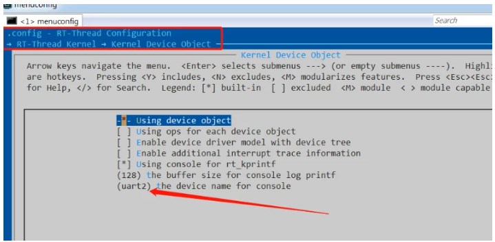

使用env工具,menuconfig进行配置,修改调试打印口的名称为uart2,如下图:
1.jpg?imageView2/2/w/1000
串口的配置,如下图:

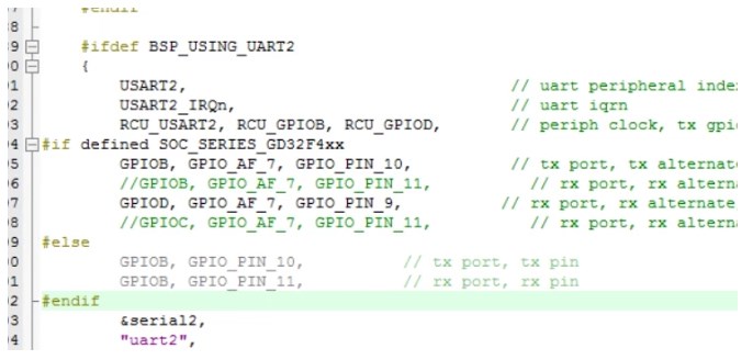

对串口2的代码进行修改,修改之后如下:
#ifdef BSP_USING_UART2
USART2, // uart peripheral index
USART2_IRQn, // uart iqrn
RCU_USART2, RCU_GPIOB, RCU_GPIOD, // periph clock, tx gpio clock, rt gpio clock
#if defined SOC_SERIES_GD32F4xx
GPIOB, GPIO_AF_7, GPIO_PIN_10, // tx port, tx alternate, tx pin
//GPIOB, GPIO_AF_7, GPIO_PIN_11, // rx port, rx alternate, rx pin
GPIOD, GPIO_AF_7, GPIO_PIN_9, // rx port, rx alternate, rx pin
//GPIOC, GPIO_AF_7, GPIO_PIN_11, // rx port, rx alternate, rx pin
#else
GPIOB, GPIO_PIN_10, // tx port, tx pin
GPIOB, GPIO_PIN_11, // rx port, rx pin
#endif
&serial2,
'uart2',
#endif

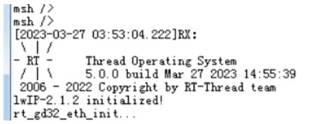

对工程进行编译,下载到开发板运行,可以看到串口2打印的信息,如下图,
