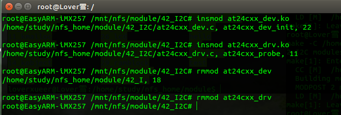

3.编译测试
结果如图所示:
afe9cc762fc38f60f41c3efd04746c84_8DcWtWMqzORnEAAAAASUVORK5CYII=.png?imageView2/2/w/1000
