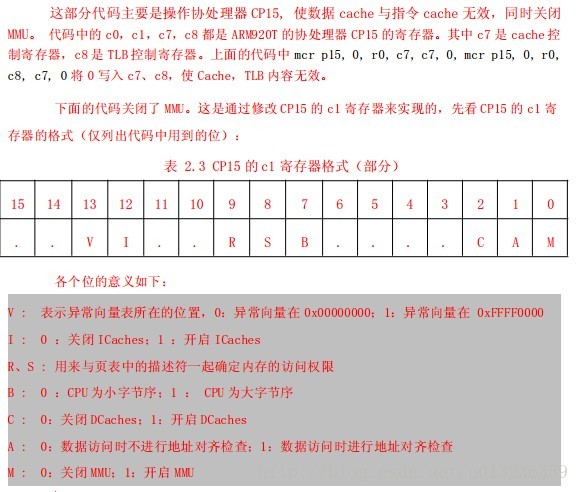

3,关闭MMU和CACHE,并调用lowlevel_init.S完成SDRAM和NANDFLASH的初始化,为代码的重定向做准备
     * we do sys-critical inits only at reboot,
     * not when booting from ram!
#ifndef CONFIG_SKIP_LOWLEVEL_INIT
    bl  cpu_init_crit  //关闭MMU和CACHE,并调用lowlevel_init.S完成SDRAM和NANDFLASH的初始化
#endif
 * CPU_init_critical registers
 * setup important registers
 * setup memory timing
cpu_init_crit:
     * flush v4 I/D caches
    mov r0, #0       //具体设置看下图,详细参考CP15指令:http://blog.csdn.net/gooogleman/article/details/3635238
    mcr p15, 0, r0, c7, c7, 0 //向c7写入0将使ICache与DCache 无效flush v3/v4 cache
    mcr p15, 0, r0, c8, c7, 0  //向c8写入0将使TLB失效 flush v4 TLB
     * disable MMU stuff and caches     //协处理器CP15的C1处理器可以设置MMU和caches,具体参考下图
    mrc p15, 0, r0, c1, c0, 0
    bic r0, r0, #0x00002300 @ clear bits 13, 9:8 (--V- --RS)
    bic r0, r0, #0x00000087 @ clear bits 7, 2:0 (B--- -CAM)
    orr r0, r0, #0x00000002 @ set bit 2 (A) Align
    orr r0, r0, #0x00001000 @ set bit 12 (I) I-Cache
    mcr p15, 0, r0, c1, c0, 0
