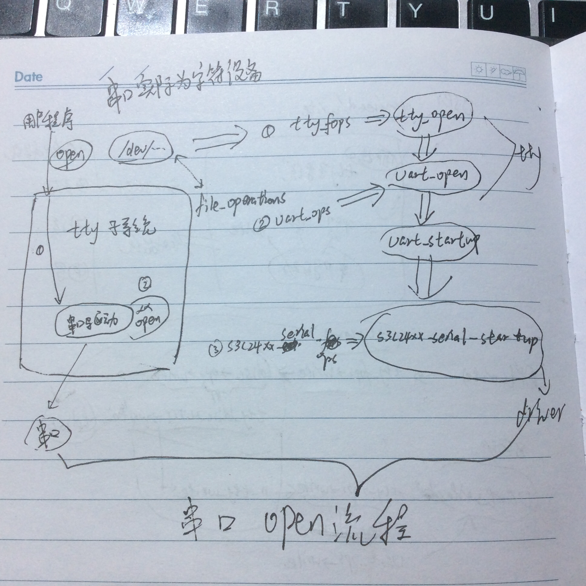

3、串口驱动分析-打开设备
static int s3c24xx_serial_startup(struct uart_port *port)
    struct s3c24xx_uart_port *ourport = to_ourport(port);
    int ret;
    dbg('s3c24xx_serial_startup: port=%p (%08lx,%p)n',
        port->mapbase, port->membase);
    rx_enabled(port) = 1;
    ret = request_irq(ourport->rx_irq, s3c24xx_serial_rx_chars, 0,
              s3c24xx_serial_portname(port), ourport);
    if (ret != 0) {
        printk(KERN_ERR 'cannot get irq %dn', ourport->rx_irq);
        return ret;
    ourport->rx_claimed = 1;
    dbg('requesting tx irq...n');
    tx_enabled(port) = 1;
    ret = request_irq(ourport->tx_irq, s3c24xx_serial_tx_chars, 0,
    if (ret) {
        printk(KERN_ERR 'cannot get irq %dn', ourport->tx_irq);
        goto err;
    ourport->tx_claimed = 1;
    dbg('s3c24xx_serial_startup okn');
    /* the port reset code should have done the correct
     * register setup for the port controls */
    return ret;
 err:
    s3c24xx_serial_shutdown(port);
    return ret;
