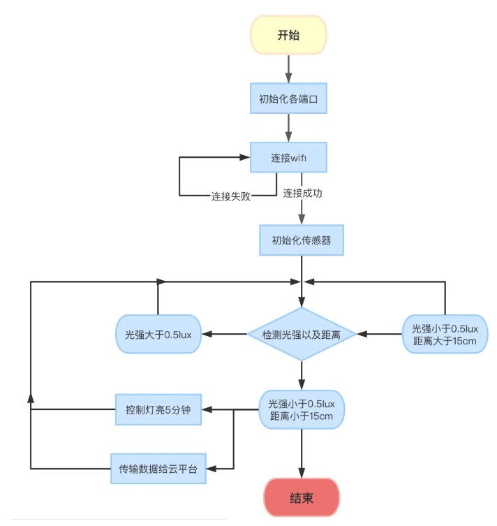

1、程序流程图
1.jpg?imageView2/2/w/1000
2、光强和距离数据的采集(判断是否有人接近,检测到人体后开启照明系统):
while (1)
        rt_pin_write(PIN_LED3, PIN_LOW);
        rt_uint16_t ps_data;        float brightness;        /* 读 接 近 感 应 值 */
        ps_data = ap3216c_read_ps_data(dev);        /* 读 光 照 强 度 值 */
        brightness = ap3216c_read_ambient_light(dev);        if (brightness <= 0.5 && ps_data <= 20)
                rt_pin_write(PIN_LED1, PIN_HIGH);
                rt_pin_write(PIN_LED2, PIN_HIGH);
            }        else if (brightness <= 0.5 && ps_data > 20)
            {                //LOG_D('ps:%d', ps_data);
                rt_pin_write(PIN_LED1, PIN_LOW);
                rt_pin_write(PIN_LED2, PIN_LOW);                add();
                rt_thread_mdelay(10000);
            }        else
        rt_thread_mdelay(399);
        rt_pin_write(PIN_LED3, PIN_HIGH);

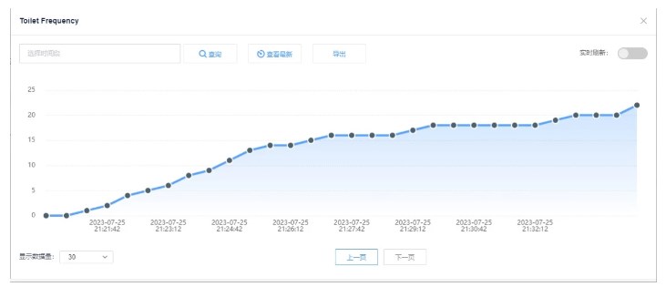

项目成品展示
1、夜间照明系统工作示意图
2、如厕频率数据实时上传onenet:
