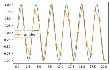

def get_data(data_path, isplot=True):
    data = loadmat(data_path)
    t_true = data['tTrueSignal'].squeeze()
    x_true = data['xTrueSignal'].squeeze()
    t_resampled = data['tResampled'].squeeze()
    # 对数据进行抽取(间隔100抽样)
    t_sampled = t_true[::100]
    x_sampled = x_true[::100]
    if isplot:
        # 绘制数据对比图1
        plt.figure(1)
        plt.plot(t_true, x_true, '-', label='true signal')
        plt.plot(t_sampled, x_sampled, 'o-', label='samples')
        plt.legend()
        plt.show()
    return t_true, x_true, t_sampled, x_sampled, t_resampled

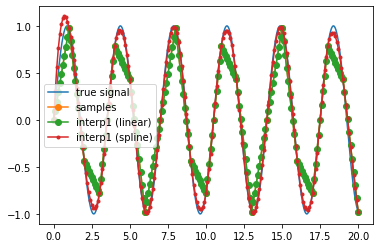

def result_visiualize(x_inter_1, x_inter_2):
    # 加载数据
    t_true, x_true, t_sampled, x_sampled, t_resampled = get_data('./data.mat', isplot=False)
    plt.figure(2)
    plt.plot(t_resampled, x_inter_1, 'o-', label='interp1 (linear)')
    plt.plot(t_resampled, x_inter_2, '.-', label='interp1 (spline)')
    plt.legend()
    plt.show()

    x_inter_1 = data_interp(t_sampled, x_sampled, t_resampled, method_index=1)
    x_inter_2 = data_interp(t_sampled, x_sampled, t_resampled, method_index=2)
    # 绘制图片
