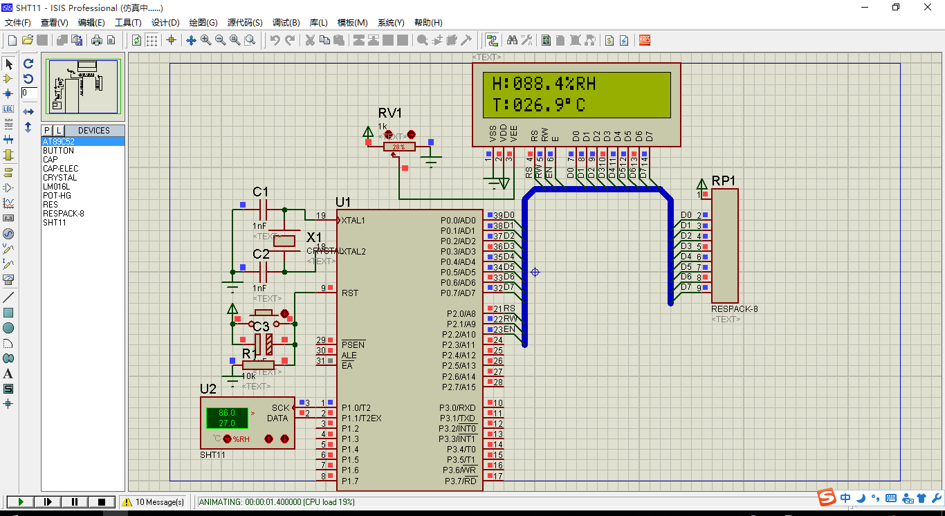

单片机程序如下:
#include
#include
#include "LCD1602.h"
宏定义
#define uint unsigned int
#define uchar unsigned char
#define noACK 0
#define ACK   1
#define STATUS_REG_W 0x06
#define STATUS_REG_R 0x07
#define MEASURE_TEMP 0x03
#define MEASURE_HUMI 0x05
#define RESET        0x1e
enum { TEMP, HUMI };
typedef union               //定义共用同类型
        unsigned int i;
        float f;
} value;
位定义
sbit SCK = P1 ^ 0;
sbit DATA = P1 ^ 1;
变量定义
uchar wendu[6];
uchar shidu[6];
50us延时函数
void delay_50us(uint t)
        uint j;
        for (; t>0; t--)
        for (j = 19; j>0; j--);
液晶显示函数
void displaywendu(void)
        uchar i;
        write_com(0x80+0x40);
        write_data('T');
        write_data(':');
        for (i = 0; i<3; i++)
                write_data(wendu[i]);
                delay_50us(1);
        for (i = 0; i<1; i++)
                write_data('.');
                delay_50us(1);
        for (i = 4; i<5; i++)
                delay_50us(1);
        write_data(0xDF);
        write_data('C');
液晶显示函数
void displayshidu(void)
        uchar i;
        write_com(0x80);
        write_data('H');
        write_data(':');
                write_data(shidu[i]);
                delay_50us(1);
                write_data('.');
                delay_50us(1);
                delay_50us(1);
        write_data('%');
        write_data('R');
        write_data('H');
SHT11写字节程序
char s_write_byte(unsigned char value)
        unsigned char i, error = 0;
        for (i = 0x80; i>0; i >>= 1)             //高位为1,循环右移
                if (i&value) DATA = 1;          //和要发送的数相与,结果为发送的位
                else DATA = 0;
                SCK = 1;
                _nop_(); _nop_(); _nop_();        //延时3us
                SCK = 0;
        DATA = 1;                           //释放数据线
        SCK = 1;
        error = DATA;                       //检查应答信号,确认通讯正常
        SCK = 0;
        DATA = 1;
        return error;                     //error=1 通讯错误
SHT11读字节程序
char s_read_byte(unsigned char ack)
        unsigned char i, val = 0;
        DATA = 1;                           //释放数据线
                SCK = 1;
                if (DATA) val = (val | i);             //读一位数据线的值
                SCK = 0;
        DATA = !ack;                        //如果是校验,读取完后结束通讯;
        SCK = 1;
        SCK = 0;
        DATA = 1;                           //释放数据线
        return val;
SHT11启动传输
void s_transstart(void)
        DATA = 1; SCK = 0;                   //准备
        _nop_();
        SCK = 1;
        _nop_();
        DATA = 0;
        _nop_();
        SCK = 0;
        SCK = 1;
        _nop_();
        DATA = 1;
        _nop_();
        SCK = 0;
SHT11连接复位
void s_connectionreset(void)
        unsigned char i;
        for (i = 0; i<9; i++)                  //DATA保持高,SCK时钟触发9次,发送启动传输,通迅即复位
                SCK = 1;
                SCK = 0;
        s_transstart();                   //启动传输
SHT11温湿度检测
char s_measure(unsigned char *p_value, unsigned char *p_checksum, unsigned char mode)
        unsigned error = 0;
        unsigned int i;
        switch (mode)                      //选择发送命令
        case TEMP: error += s_write_byte(MEASURE_TEMP); break;          //测量温度
        case HUMI: error += s_write_byte(MEASURE_HUMI); break;          //测量湿度
        default: break;
        for (i = 0; i<65535; i++) if (DATA == 0) break;        //等待测量结束
        if (DATA) error += 1;                              // 如果长时间数据线没有拉低,说明测量错误
        *(p_value) = s_read_byte(ACK);           //读第一个字节,高字节 (MSB)
        *(p_value + 1) = s_read_byte(ACK);          //读第二个字节,低字节 (LSB)
        *p_checksum = s_read_byte(noACK);        //read CRC校验码
        return error;                   // error=1 通讯错误
