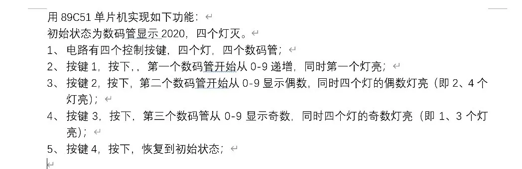

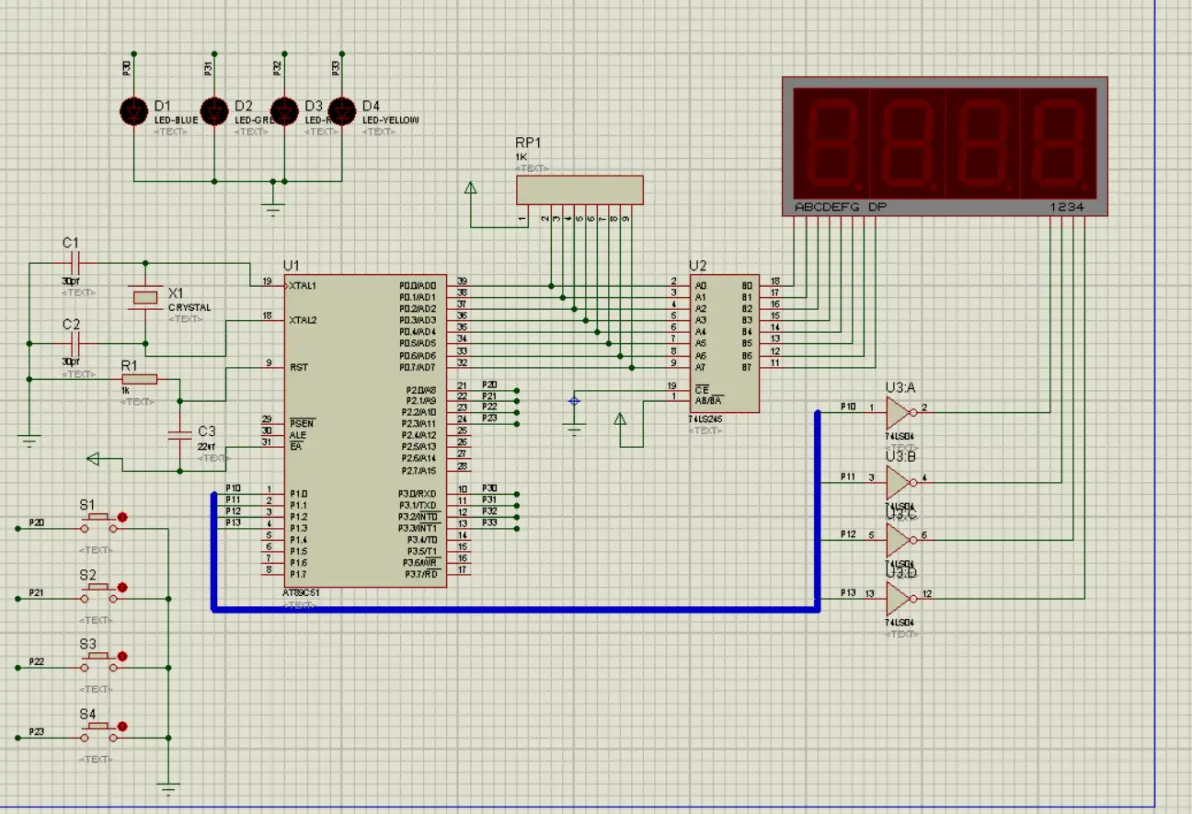

  • 任务描述:用89C51单片机实现如下功能:<初始状态为数码管显示2020,四个灯灭。 1、电路有四个控制按键,四个灯,四个数码管; 2、按键1,按下,,第一个数码管开始从0-9递增,同时第一个灯亮; 3、按键2,按下,第二个数码管开始从0-9显示偶数,同时四个灯的偶数灯亮(即2、4个灯亮); 4、按键3,按下,第三个数码管从0-9显示奇数,同时四个灯的奇数灯亮(即1、3个灯亮); 5、按键4,按下,恢复到初始状态;

#include<reg51.h>
unsigned char tube1[]={0x5b,0x3f,0x5b,0x3f};//数码管初始状态2020 字符码
unsigned char tube2[]={0x3f,0x06,0x5b,0x4f,0x66,0x6d,0x7d,0x07,0x7f,0x6f};//共阴极字符码
sbit key1=P2^0;
sbit key2=P2^1;
sbit key3=P2^2;
sbit key4=P2^3;
sbit led1=P3^0;
sbit led2=P3^1;
sbit led3=P3^2;
sbit led4=P3^3;
void delay(unsigned int time);
void main()
   unsigned char i,W;
   while(1)
    if(key1==1&key2==1&key3==1)   //初始状态
W=0x01;
P3=0X00;
    for(i=0;i<4;i++)
     P1 =W;
W<<=1;
      P0=tube1[i];
     delay(10);
      P1 =0x00;
  if(key1==0)    //  按键1按下
  delay(10);
  if(key1==0)
  led1=1;
  led2=0;
  led3=0;
  led4=0;
   W=0x08;
  for(i=0;i<10;i++)
  if(key2==0|key3==0|key4==0)
  break;
      P1 =W;
      P0=tube2[i];
      delay(1000);
      P1 =0x00;
     while(!key1);
       delay(10);
while(!key1);
  if(key2==0)    //按键2按下
  delay(10);
  if(key2==0)
   led1=0;
   led3=0;
   led2=1;
   led4=1;
   W=0x04;
  for(i=0;i<10;i=i+2)
   if(key1==0|key3==0|key4==0)
  break;
      P1 =W;
      P0=tube2[i];
      delay(1000);
      P1 =0x00;
     while(!key2);
delay(10);
while(!key2);
    if(key3==0)    //按键3按下
  delay(10);
  if(key3==0)
   led1=1;
   led3=1;
   led2=0;
   led4=0;
   W=0x02;
  for(i=1;i<10;i=i+2)
   if(key2==0|key1==0|key4==0)
  break;
      P1 =W;
      P0=tube2[i];
      delay(1000);
      P1 =0x00;
     while(!key3);
delay(10);
while(!key3);
   unsigned int j;
   for(;time> 0;time--)
   for(j=0;j<125;j++);
