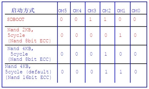

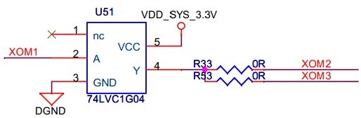

由图上所知,由OM(Operating Mode)pin导入到iROM中,OM是什么?打开Tiny210V2_V1.0_120713_sch.pdf的原理图,搜索OM
查找到一个表格,有上表可知,OM1/OM2/OM3决定的是从SD卡启动还是从Nand Flash启动。

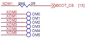

继续往下看,由图可知,OM1/OM2/OM3分别接在XOM1/XOM2/XOM3上面。

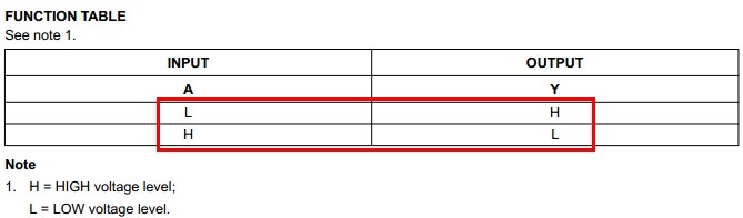

再来看旁边XOM的一个信号反相器74LVC1G04的图

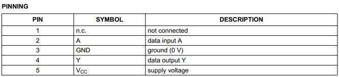

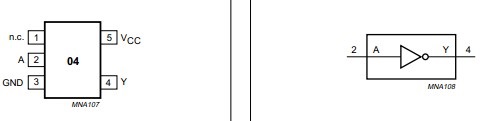

查看74LVC1G04原理图,找到pin脚图和逻辑图
由图可知,这是一个反相器,2中输入高电平,则4中输出低电平;2中输入低电平,则4中输出高电平,OK。
当XOM拨到1时,XOM1为NC状态,XOM1 = 0,pin4的输出为1,XOM2=XOM3=1,则为0-1-1,为SDBOOT;
当XOM拨到2时,XOM1为输入状态,XOM1 = 1,pin4的输出为0,XOM2 = XOM3 = 0,为1-0-0,Nand启动模式,至此,OM的输入判断分析结束。

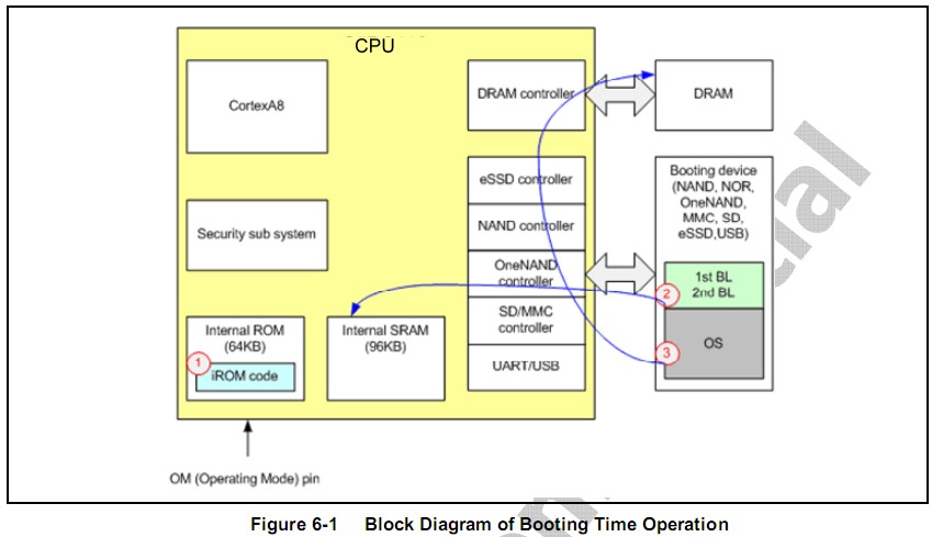

继续看芯片手册,手册上关于iROM/iRAM及Bootloader描述如下:
  • The iROM code is placed in internal 64KB ROM. It initializes basic system functions such as clock, stack, and heap.
  • The iROM loads the first boot loader image from a specific booting device to internal 96KB SRAM. The booting device is selected by Operating Mode (OM) pins. According to the secure boot key values, the iROM code may do an integrity check on the first boot loader image.
  • The first boot loader loads the second boot loader then may check the integrity of the second boot loader according the secure boot key values.
  • The second boot loader initializes system clock, UART, and DRAM controller. After initializing DRAM controller, it loads OS image from the booting device to DRAM. According to the secure boot key values, the second boot loader can do an integrity check on the OS image.
  • After the booting completes, the second boot loader jumps to the operating system.
