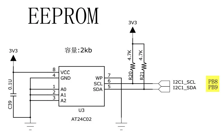

 * AT24C02 2kb = 2048bit = 2048/8 B = 256 B
 * 32 pages of 8 bytes each
 * Device Address
 * 1 0 1 0 A2 A1 A0 R/W
 * 1 0 1 0 0  0  0  0 = 0XA0
 * 1 0 1 0 0  0  0  1 = 0XA1

  * @brief  I2C1 I/O配置
  * @param  无
  * @retval 无
static void I2C_GPIO_Config(void)
  GPIO_InitTypeDef  GPIO_InitStructure;
  /*!< EEPROM_I2C Periph clock enable */
  EEPROM_I2C_CLK_INIT(EEPROM_I2C_CLK, ENABLE);
  /*!< EEPROM_I2C_SCL_GPIO_CLK and EEPROM_I2C_SDA_GPIO_CLK Periph clock enable */
  RCC_AHB1PeriphClockCmd(EEPROM_I2C_SCL_GPIO_CLK | EEPROM_I2C_SDA_GPIO_CLK, ENABLE);
  /*!< GPIO configuration */
  /* Connect PXx to I2C_SCL*/
  GPIO_PinAFConfig(EEPROM_I2C_SCL_GPIO_PORT, EEPROM_I2C_SCL_SOURCE, EEPROM_I2C_SCL_AF);
  /* Connect PXx to I2C_SDA*/
  GPIO_PinAFConfig(EEPROM_I2C_SDA_GPIO_PORT, EEPROM_I2C_SDA_SOURCE, EEPROM_I2C_SDA_AF);
  /*!< Configure EEPROM_I2C pins: SCL */
  GPIO_InitStructure.GPIO_Pin = EEPROM_I2C_SCL_PIN;
  GPIO_InitStructure.GPIO_Mode = GPIO_Mode_AF;
  GPIO_InitStructure.GPIO_Speed = GPIO_Speed_50MHz;
  GPIO_InitStructure.GPIO_OType = GPIO_OType_OD;
  GPIO_InitStructure.GPIO_PuPd  = GPIO_PuPd_NOPULL;
  GPIO_Init(EEPROM_I2C_SCL_GPIO_PORT, &GPIO_InitStructure);
  /*!< Configure EEPROM_I2C pins: SDA */
  GPIO_InitStructure.GPIO_Pin = EEPROM_I2C_SDA_PIN;
  GPIO_Init(EEPROM_I2C_SDA_GPIO_PORT, &GPIO_InitStructure);
