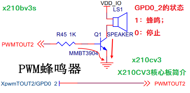

HW-BEEP
电路中通过一个NPN的三级管控制蜂鸣器的停止与蜂鸣。
GPIOGPD0_2输出高电平,蜂鸣器鸣叫;反之,停止鸣叫。

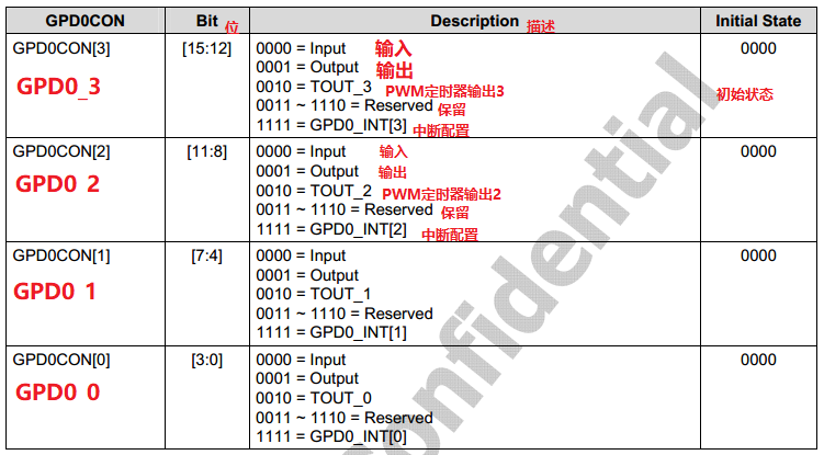

2.2.7.1 Port Group GPD0 Control Register (GPD0CON, R/W, Address = 0xE020_00A0)
GPD0CON

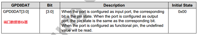

2.2.7.2 Port Group GPD0 Control Register (GPD0DAT, R/W, Address = 0xE020_00A4)
GPD0DAT

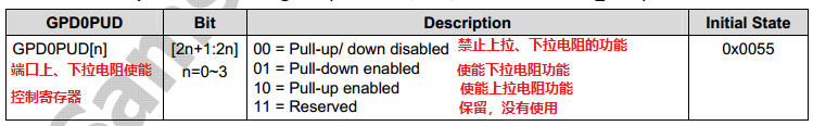

2.2.7.3 Port Group GPD0 Control Register (GPD0PUD, R/W, Address = 0xE020_00A8)
GPD0PUD

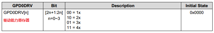

2.2.7.4 Port Group GPD0 Control Register (GPD0DRV, R/W, Address = 0xE020_00AC)
GPD0DRV

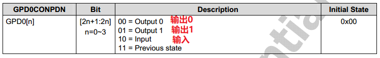

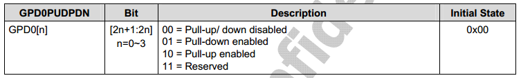

2.2.7.5 Port Group GPD0 Control Register (GPD0CONPDN, R/W, Address = 0xE020_00B0)
GPD0PUDPDN
2.2.7.6 Port Group GPD0 Control Register (GPD0PUDPDN, R/W, Address = 0xE020_00B4)
GPD0PUDPDN

void beep_init(void)
    GPD0.GPD0CON = (GPD0.GPD0CON & ~(0xf<<8)) | (0x1<<8);
    GPD0.GPD0DAT = (GPD0.GPD0DAT & ~(0x1<<2)) | (0x0<<2);
