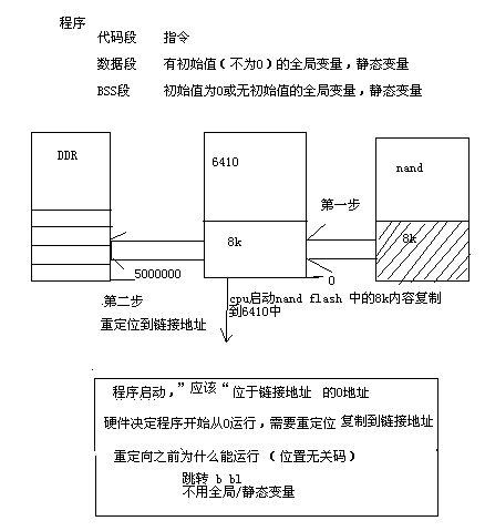

链接地址学习笔记
发布者:EnchantedMelody最新更新时间:2024-10-15 来源: cnblogs关键字:链接地址  学习笔记  启动过程 手机看文章 扫描二维码
随时随地手机看文章
链接地址
启动过程
示例代码如下:
start.S 文件
.globl _start
_start:
/*硬件相关设置*/
ldr r0,=0x70000000
orr r0,r0,#0x13
mcr p15,0,r0,c15,c2,4
/*关看门狗*/
    bl test  /*位置无关*/
ldr pc, =test /*位置相关*/
ldr r0,=0x7E00400
mov r1,#0
str r1,[r0]
/*设置栈*/
ldr sp,=8*1024
bl main
halt:
b halt
test:
mov pc,lr

Leds.lds文件
SECTIONS
. = 0x50000000;
.text : {
start.o
* (.text)
.data : {
* (.data)
bss_start = .;
.bss : {
* (.bss)
bss_end  = .;
Makefile 文件
led.bin: start.o led.o
arm-linux-ld -T leds.lds -o led.elf start.o led.o
arm-linux-objcopy -O binary led.elf led.bin
arm-linux-objdump -D led.elf > led.dis
start.o : start.S
arm-linux-gcc -o start.o start.S -c
led.o:led.c
arm-linux-gcc -o led.o led.c -c
clean:
rm *.o led.elf led.bin led.dis

首地址为0
Disassembly of section .ARM.attributes:
00000000 <.ARM.attributes>:
   0: 00003341  andeq r3, r0, r1, asr #6
   4: 61656100  cmnvs r5, r0, lsl #2
   8: 01006962  tsteq r0, r2, ror #18
   c: 00000029  andeq r0, r0, r9, lsr #32
  10: 4d524105  ldfmie f4, [r2, #-20] ; 0xffffffec
  14: 36373131  undefined instruction 0x36373131
  18: 2d465a4a  vstrcs s11, [r6, #-296] ; 0xfffffed8
  1c: 09060053  stmdbeq r6, {r0, r1, r4, r6}
  20: 01090108  tsteq r9, r8, lsl #2
  24: 0412020a  ldreq r0, [r2], #-522 ; 0x20a
  28: 01150114  tsteq r5, r4, lsl r1
  2c: 01180317  tsteq r8, r7, lsl r3
  30: 031b021a  tsteq fp, #-1610612735 ; 0xa0000001
led.elf:     file format elf32-littlearm
Disassembly of section .text:
00000000 <_start>:
   0:   e3a00207        mov     r0, #1879048192 ; 0x70000000
   4:   e3800013        orr     r0, r0, #19
   8:   ee0f0f92        mcr     15, 0, r0, cr15, cr2, {4}
  Bl  test 的机器码   eb00,0006
                     1110, 1011,0000 0000 0000 0000 0000  0110
                     1确定b/bl
                      剩余为偏移量
Branch instruction contains a signed 2's complement 24 bit offset. This is shifted left two bits, sign extended to 32
[1] [2]
