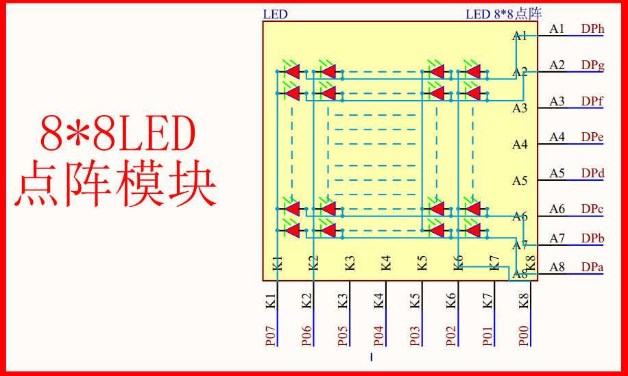

1 功能:
(1)静态显示:显示一个笑脸;
(2)动态显示:a,移动显示“HELLO!”,b,显示笑脸哭脸的变化;
2 原理
3 框图
4 硬件原理图
5 软件设计
5.1 静态显示源程序
(1)主函数
#include
#include 'delay100ms.h'

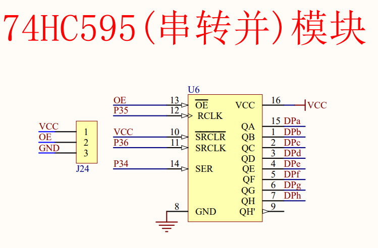

sbit SER = P3^4;    //74HC595的串行数据输入DS
sbit RCK = P3^5;    //74HC595的移位寄存器SH_CP
sbit SCK = P3^6;    //74HC595的锁存寄存器ST_CP
#define matrixled_col P0
//笑脸的数据,列向取模
unsigned char code disp[]={0x3C,0x42,0xA9,0x85,0x85,0xA9,0x42,0x3C};
    * @brief:74HC595写入一个字节
    * @param:需要写入的字节
    * @retval:无
void hc74595_wrbyte(unsigned char byte)
    unsigned char i;
    for(i=0;i<8;i++)
        SER = byte & (0x80>>i);
        SCK = 1;
        SCK = 0;
    RCK = 1;
    RCK = 0;
    * @brief:LED点阵显示屏显示1列数据
    * @param: column 选择要显示的列,范围0-7,0在最左边
    * @param: dat 选择列显示的数据,高位在上,1为亮,0为灭
    * @retval:无
void matrixled_showcol(unsigned char column,dat)
    hc74595_wrbyte(dat);
    matrixled_col = ~(0x80>>column);
    delay100ms(1);
    matrixled_col = 0xff;
void main()
    unsigned char     i;
    SCK = 0;
    RCK = 0;
    while(1)
        for(i=0;i<8;i++)
            matrixled_showcol(i,disp[i]);
    * @param:需要写入的字节
    * @retval:无
    unsigned char i;
    for(i=0;i<8;i++)
        SCK = 1;
        SCK = 0;
    RCK = 1;
    RCK = 0;
