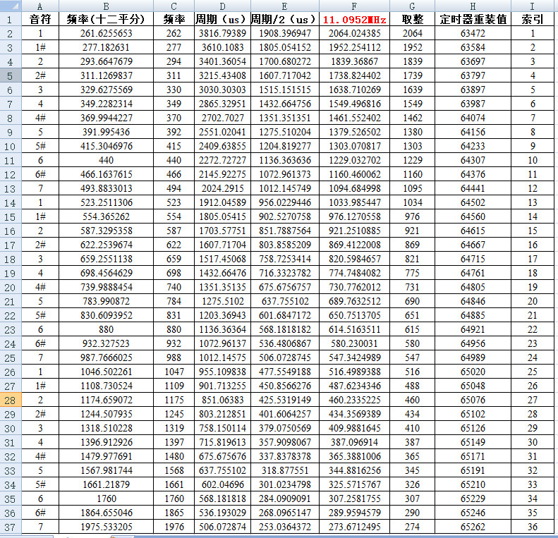

//索引与频率对照表
unsigned int FreqTable[]={
    0,
    63472,63584,63697,63797,63897,63987,64074,64156,64233,64307,64376,64441,
    64502,64560,64615,64667,64715,64761,64805,64846,64885,64921,64956,64989,
    65020,65048,65076,65102,65126,65149,65171,65191,65210,65229,65246,65262

    if(FreqTable[FreqSelect])    //如果不是休止符
        /*取对应频率值的重装载值到定时器*/
        TL0 = FreqTable[FreqSelect]%256;        //设置定时初值
        TH0 = FreqTable[FreqSelect]/256;        //设置定时初值
        buzzer=!buzzer;    //翻转蜂鸣器IO口

    TMOD &= 0xF0;    //设置定时器模式,1111_0000,&,高四位保留,低四位清零
    TMOD |= 0x01;    //设置定时器模式,0000_0001,|,高四位保留,设置模式为T0
    TL0 = 0x66;        //设置定时初始值,1ms,@11.0592MHz
    TH0 = 0xFC;        //设置定时初始值,1ms,@11.0592MHz
    TF0 = 0;        //清除TF0标志
    TR0 = 1;        //定时器0开始计时
    ET0=1;            //打开定时器T0中断开关
    EA=1;            //打开中断系统总开关
    PT0=0;            //设置T0中断优先级,低
