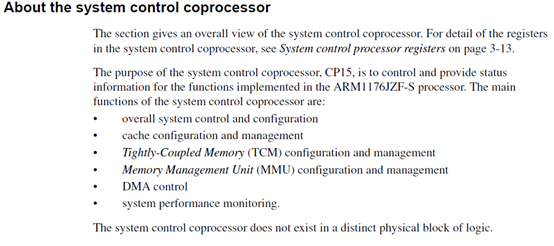

在ARM11核的文档看到图1-1:
The section gives an overall view of the system control coprocessor. For detail of the registers
in the system control coprocessor, see System control processor registers on page 3-13.
The purpose of the system control coprocessor, CP15, is to control and provide status
information for the functions implemented in the ARM1176JZF-S processor. The main
functions of the system control coprocessor are:
• overall system control and configuration
• cache configuration and management
• Tightly-Coupled Memory (TCM) configuration and management
• Memory Management Unit (MMU) configuration and management
• DMA control
• system performance monitoring.
The system control coprocessor does not exist in a distinct physical block of logic.
图1-1
从上面知道:
系统控制协处理器的功能是:
  1. 系统整体控制和配置
  2. 缓存配置和管理
  3. 紧耦合的内存(CTM)的配置和管理
  4. 内存管理单元(MMU)的配置和管理。
  5. DMA控制
  6. 系统性能控制。

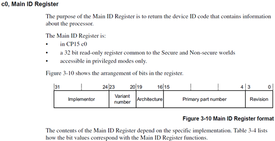

确切的说,ARM11核中有16组协处理器,不是16个,每一组里面有很多寄存器,下面来看ARM11核的c0组里的Main ID寄存器。

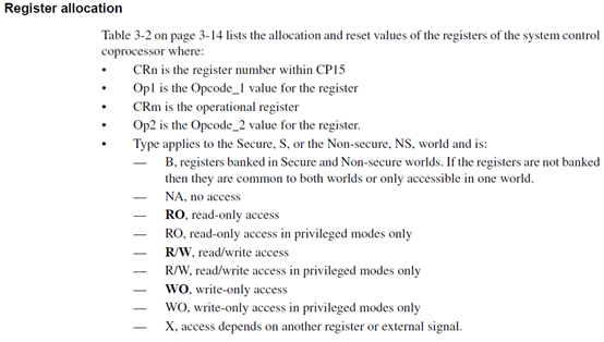

This section gives details of all the registers in the system control coprocessor. The section
presents a summary of the registers and detailed descriptions in register order of CRn,
Opcode_1, CRm, Opcode_2.

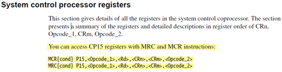

You can access CP15 registers with MRC and MCR instructions:
MCR{cond} P15,,,,,
MRC{cond} P15,,,,,
Register allocation

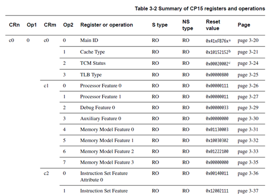

Table 3-2 on page 3-14 lists the allocation and reset values of the registers of the system control
coprocessor where:
• CRn is the register number within CP15
• Op1 is the Opcode_1 value for the register
• CRm is the operational register
• Op2 is the Opcode_2 value for the register.
• Type applies to the Secure, S, or the Non-secure, NS, world and is:
— B, registers banked in Secure and Non-secure worlds. If the registers are not banked
then they are common to both worlds or only accessible in one world.
— NA, no access
— RO, read-only access
— RO, read-only access in privileged modes only
— R/W, read/write access
— R/W, read/write access in privileged modes only
— WO, write-only access
— WO, write-only access in privileged modes only
— X, access depends on another register or external signal.

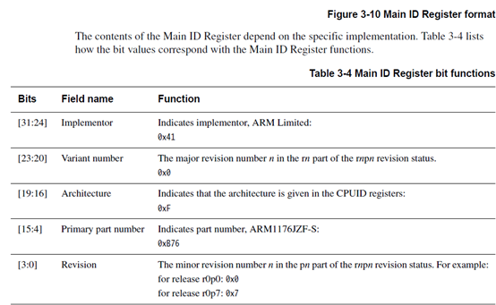

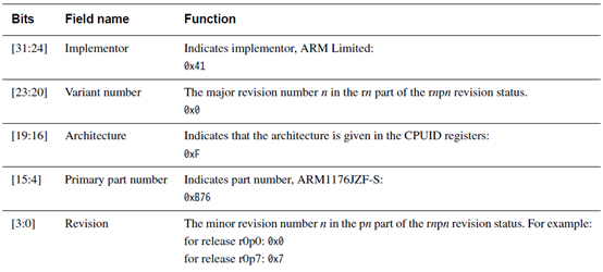

Main ID寄存器的参数:
从上面c0组的Main ID寄存器,有32位,这32位被分成了5个地址段。例如[15:4]地址段是表明这是ARM11的处理器。此处的值是0xB76

指令的格式:
MCR{cond} P15,,,,,
MRC{cond} P15,,,,,
上面是CP15的访问格式,CP14-CP0同理。
各个参数的值,上面的表格已经给出了:

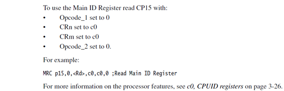

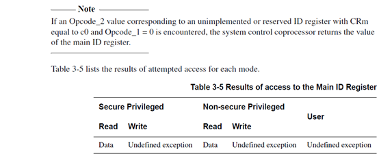

上图看到在c0组的Main ID寄存器,在设置mrc,把Main ID寄存器的内容读到r1寄存器:
从上图知道:
  1. CRn=c0:c0组的
  2. Op1=0
  3. CRm=c0
  4. Op2=0
  5. Rd=r1:就是要把Main ID读到r0寄存器。

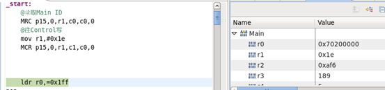

这样就设置好了。接下来实验访问Main ID:
读取Main ID指令:
MRC P15,0,r1,c0,c0,0
运行结果:
读出来的值是0x410fb766,这跟我们的核手册的说明里的值是一致的,下图。说明读取成功:
上图中[31:24]=0x41,[23:20]=0x0,[19:16]=0xF,[15:4]=0xB76,最后四位[3:0]是修订位,是在0x0到0x7之间,这里是6,也是对的。所以读出正确。
上面就是对CP15里的Main ID的读取操作。

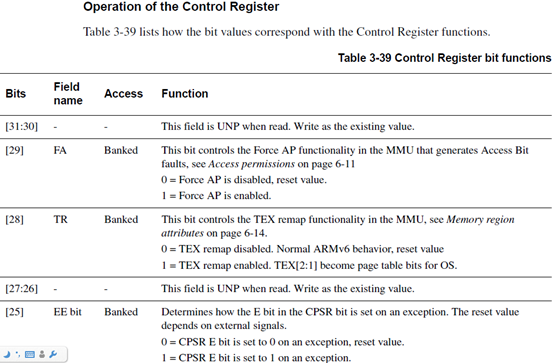

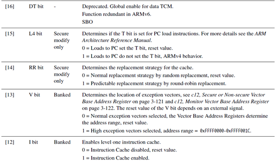

接下来是往Control寄存器里写数据:
往c1组的Control寄存器写入r1寄存器的值:
MCR P15,0,r1,c1,c0,0
上面运行了,就把r1的值写进去了。
