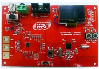

大联大世平低功耗蓝牙解决方案
CSR CSR1000/CSR1010
oSoc BLE, 64K RAM & 64K ROM,10 bit ADC
o3KHz or 16MHz Crystal, QFN32,5mm * 5mm
图示5-大联大世平CSR低功耗蓝牙解决方案照片
Epcos-TDK SESUB-PAN-T2541
oBLE class 2, TX @ 20mA ; RX @ 21mA
oSleep mode 1.4uA, I²C/SPI Interface
oUART/SPI/I²C/GPIO/ADC interface
o4.6x5.6x1.0mm package
o3mm * 3mm * 0.785 mm package
图示6-大联大世平Epcos-TDK低功耗蓝牙解决方案
TI CC254X
o2.4-GHz BLE Compliant and Proprietary RF System-on-Chip
oHigh-Performance and Low-Power 8051 Microcontroller Core
oIn-System-Programmable Flash, 128- or 256-KB
oRX Down to: 14.7 mA (3-V supply), TX (0 dBm): 14.3 mA (3-V supply)
o6-mm × 6-mm QFN-40 Package
图示7-大联大世平TI低功耗蓝牙解决方案照片
Toshiba TC35667
oROM 384kBytes, RAM 96kBytes
oTX @ 6.1mA ; RX @ 7.7mA
oDeep Sleep mode 0.08uA
图示8-大联大世平Toshiba低功耗蓝牙解决方案照片
