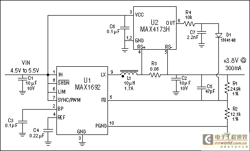

  • A current limit can be added to a step-down converter by using a MAX4173H current-sense amplifier to inject current into the feedback network. D1 sharpens the threshold of current limit by converting the current sense feedback signal from linear to exponential. This current-limit circuit can be scaled for any output current by adjusting R3. In this case, the MAX1692 provides up to 600mA output and the MAX4173H limits the output current by decreasing the output voltage for output current above 300mA.
    IL (mA) VOUT (V)
    0 3.827
    100 3.729
    200 3.701
    258 3.637 (-5%)
    300 3.503
    312 3.444 (-10%)
    347 3.254 (-15%)
    380 3.062 (-20%)
    400 2.951
    414 2.862 (-25%)
    450 2.630
    500 2.305
    550 1.977
    600 1.732
