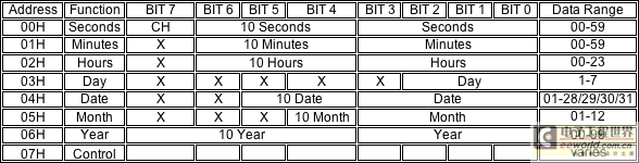

There are three major data formats used in RTCs: binary-coded decimal (BCD), binary with separate registers for the month, date, year, etc., and elapsed-time counters.
BCD
The BCD format is the most common. One reason for its popularity is that the time and date can be easily displayed in a human-readable format with no "conversion." Each 8-bit register represents two digits (one nibble per digit). Each 4-bit nibble can hold the binary representation of the digits 0 through 9. An example of the register map for a typical BCD format clock is shown in Figure 1.
Since some of bits are not needed for a particular time or date field, those bits can be used for special functions, general-purpose read/write bits, or can be hardwired to read back as always one or zero, depending upon the design. In Figure 1, bit 7 of the seconds register is used for the clock halt (CH) bit. (See the DS1307 data sheet for an example.)
Figure 1. Typical time and date register map (BCD format).

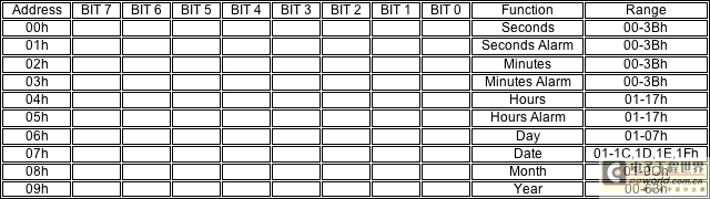

The second clock format is the binary format (Figure 2), with separate registers like the BCD format. The binary format is normally a programmable option on some clocks with the BCD format. (See the DS12885 data sheet for an example of this format.)
Figure 2. Typical time and date register map (binary format).

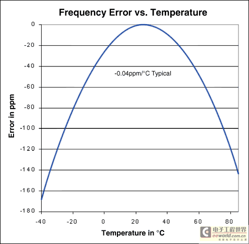

The crystal oscillator is one of the most accurate circuits available for providing a fixed frequency. A 32,768Hz crystal is used for most RTCs. By dividing down the output of the oscillator, a 1Hz reference can be used to update the time and date. The accuracy of the RTC is dependent mainly upon the accuracy of the crystal. Tuning-fork crystals have a parabolic frequency response across temperature (Figure 3). An error of 23ppm is about 1 minute per month. For further reference, see the Real-Time Clock Calculator. Crystals are tuned to oscillate at the correct frequency under a particular capacitive load. Using a crystal tuned for a 12.5pF load on an RTC designed to present a 6pF load to the crystal will cause the clock to run too fast.
Figure 3. Crystal accuracy vs.temperature.

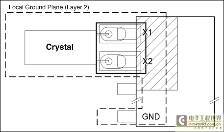

All Dallas Semiconductor RTC oscillators have internal bias networks. The crystal should be connected directly to the X1 and X2 pins with no additional components (Figure 4). The crystal should also be as close as possible to the X1 and X2 pins, and a ground plane should be placed beneath the crystal, X1, and X2 (Figure 5). Digital signal lines should be routed away from the crystal and oscillator pins. Low-power crystal-oscillator circuits can be sensitive to nearby RFI, which can cause the clock to run fast. Consequently, components that radiate significant levels of RFI should be shielded and located away from the crystal.
Figure 4. RTC equivelent circuit showing the internal bias network.
Figure 5. Typical crystal layout.
PC boards containing tuning-fork crystals, such as those used with RTCs, should not be cleaned using ultrasonics. The crystal can be damaged by resonance vibration.

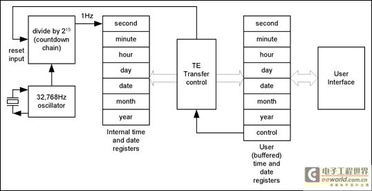

A second set of registers (secondary buffer or "user" registers) are used on most serial clocks. When the time and date registers are accessed, the current time and date are transferred to the secondary registers. A burst read will take the data from the secondary registers, which remain unchanged while the internal registers continue to update. The next access (when CE goes active on a 3-wire device or a START on I²C interface devices occurs) will transfer the data again. When writing to the time and date registers, the internal countdown chain is reset when the seconds register is written. That allows the program almost one second in which to write the remaining time and date registers before a rollover occurs.
On timekeeping NV RAM clocks, either a transfer enable (TE) bit or (R)ead and (W)rite bits are used to "freeze" the user registers. Setting the R bit or the TE bit keeps the user registers from being updated from the main registers. Resetting the TE bit or the W bit after writing the user register loads the internal time and date registers with the values from the user registers.
The block diagram in Figure 8 shows typical functions for transferring time and date information between the internal registers and the user interface. The 32,768Hz signal from the oscillator is divided down to 1Hz by a countdown chain that has a reset input. The 1Hz signal from the countdown chain drives the BCD seconds counter/register. The ripple output from the seconds counter feeds the minutes counter/register, and so on. Changing the R and W bits in the control register synchronizes the transfer of data from the internal registers to the user registers. The Transfer Control block sends a reset to the countdown chain when transferring data from the user registers to the internal registers. This allows synchronization of the clock to an external reference to within approximately 244µs (most clocks do not reset the first three dividers, to the 4,096Hz signal; 1/4,096Hz244µs). Most serial-interface clocks reset the countdown chain whenever the seconds register is written.
Figure 8. Block diagram showing internal and user copy of time and date registers.

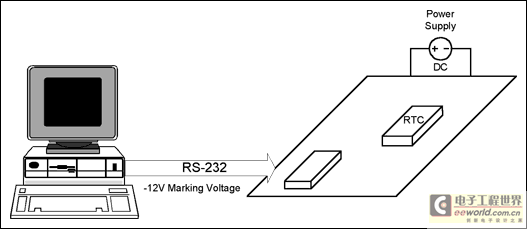

Another source of negative voltages on the clock can come from RS-232 connections. If the PCB with the clock IC is powered down, and a powered PC or other instrument is connected to that board with an RS-232 connection, the RS-232 transceiver can pass the negative marking voltage onto other ICs on the unpowered board (see Figure 9). To verify that this as a problem, try cycling power on the system with the RS-232 link disconnected.
Figure 9. System connected to a PC using RS-232.
