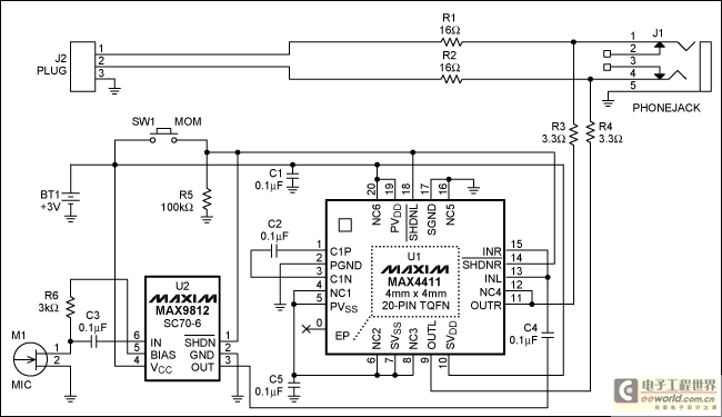

Abstract: This application note presents a circuit that reduces input amplitude and amplifies a microphone input. Designed for use with earbuds, the circuit enables clear sound for conversation even when the earbuds are used with low-cost, less-sensitive headphones. The MAX4411 headphone amplifier and MAX9821 microphone amplifier are featured.

Fortunately, both of these problems are solved with a single circuit (Figure 1). R1 and R2 reduce the input amplitude. The other circuitry amplifies the microphone input and injects that amplified signal into the left and right headphone-signal paths, thus producing an audible feedback when you speak.
Figure 1. This headphone attenuator/amplifier has a microphone monitor and allows easy conversation while wearing earbuds.
Both the headphone amplifier (U1, the MAX4411) and microphone amplifier (U2, the MAX9812) connect directly to a 3V battery. During normal operation both devices are in shutdown, drawing mere microamperes from the battery. To speak with someone, you need only depress the momentary switch, SW1, to activate the microphone. That action enables the microphone amplifier's bias output which allows it to amplify the external sound. The headphone amplifier connects to this amplified sound and injects it into the headphone audio with resistors R3 and R4. As an added benefit of this mixing, the headphone amplifier's low-output impedance (when enabled) further attenuates the original audio stream.
The monitor circuit's sensitivity is adjusted by changing the values of R3 and R4. The audio-input attenuation is adjusted by changing the values of R1 and R2. Microphone, headphone jack, momentary switch, battery, and other circuitry fit in an enclosure the size of a key fob, with a ~1m cable and headphone plug attached.
