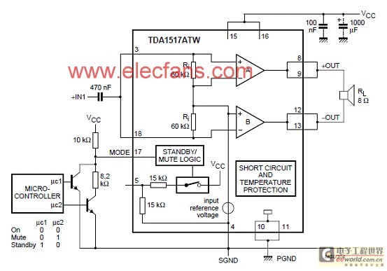

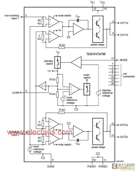

TDA1517ATW是NXP公司的8W BTL或2 × 4 W SE音频功率放大器,在HTSSOP20封装内集成了AB类输出放大器,可用作单声道桥接负载(BTL)或立体声单端(SE)连接,具有良好的波纹抑制以及AC和DC短路安全。本文介绍了TDA1517ATW主要特性,方框图以及BTL和SE连接应用框图。
TDA1517ATW:8 W BTL or 2 × 4 W SE power amplifier
The TDA1517ATW is an integrated class-AB output amplifier contained in a plastic heatsink thin shrink small outline package (HTSSOP20). The device is primarily developed for multimedia applications.

图1。TDA1517ATW 方框图
图2。TDA1517ATW BTL 应用方框图
