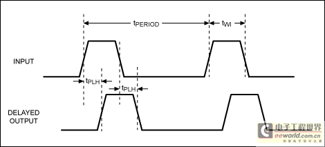

Calculating Maximum Input Frequency计算最大输入频率
When calculating the maximum input frequency, the critical parameter to consider is the minimum pulse width of the input signal.当计算的最大输入频率,最重要的参数要考虑的是输入信号的最小脉冲宽度。 For periodic signals with a 50% duty cycle, the minimum pulse width would be half the period of the signal.对于具有50%的占空比,最小脉宽周期信号将一半的一段期间的信号。 This value, in turn, determines the maximum possible delay.此值,从而决定了最大可能延误。 Sometimes the input is periodic with a low frequency, but with a duty cycle of less than 50%.有时,是周期性的输入与低频,但低于50%的占空比。 In this case, the width of the minimum duration between transitions (t WI ) on the input determines the minimum pulse width ( Figure 1 ).在这种情况下,之间的转换(吨威斯康星州 )最短的输入宽度确定最小脉宽( 图1)。 In a number of devices, the minimum-input pulse width possible is specified as 100% of the maximum output delay desired (if not explicitly specified).在许多设备,最小输入脉冲宽度可能被指定为100%,最高产量所需的延迟(如果没有明确规定)。 The maximum output delay for these devices is, therefore (conversely), the same as the minimum-input pulse width.这些器件的最大输出延迟,因此(反过来),在相同的最低输入脉冲宽度。
图1。图显示了与过渡的TWI(输入信号的)最低期限确定最大的延误。
Figure 1. 图1。 Illustration shows how the minimum duration between transitions (t WI ) of the input signal determines the maximum possible delay. 图显示与输入信号的转换(吨威斯康星州 )最低期限确定最大的延误。

The minimum-input pulse width is usually specified explicitly in the data sheet, but is sometimes specified relative to the output delay desired.最低输入脉冲宽度通常是显式指定的数据表,但有时指定相对于输出延迟理想。 Therefore, to calculate the minimum-input pulse width, we consider the minimum delay that can be programmed, which is the same as the zero-step delay.因此,计算最小输入脉冲宽度,我们认为,最低延迟,可以进行编程,这是作为零延迟步相同。 The data sheet also specifies an error or tolerance over temperature and voltage.数据表还指定了一个错误或以上的温度和电压容忍。 This error is added to the zero-step delay to determine the maximum zero-step delay.此错误添加到零延迟步确定最大零步延迟。 The maximum zero-step delay is essentially the minimum pulse width to consider (t WI_MIN ).最高零一步延迟基本上是最小脉宽考虑(吨WI_MIN)。 The maximum frequency (f IN_MAX ) can then be calculated from the minimum-input pulse width using the following formula:最高频率(f IN_MAX)便可计算出的最小输入脉冲宽度使用下列公式:
公式1
