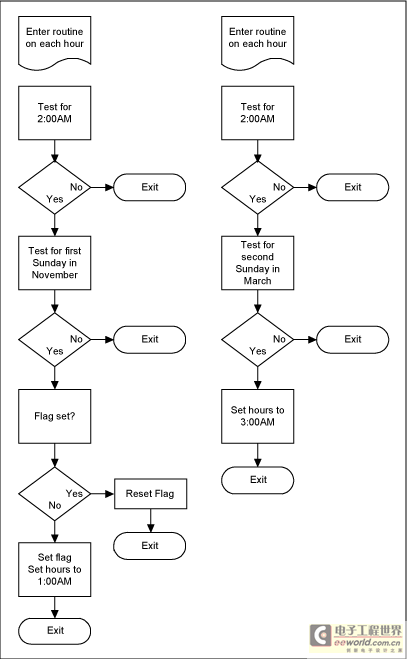

Meanwhile, if you are managing changes for DST with an RTC, the Figure 1 flowchart will help you. It shows the basic steps required to test and adjust for DST. When adjusting back to standard time in November, a flag must be used to determine if the shift from 2:00AM to 1:00AM already occurred. This bit should be nonvolatile in case a power failure occurs in the hour after time has been reset to 1:00AM. A bit in one of the RTC's general-purpose battery-backed registers could be used for this purpose.

Figure 1. Flowchart of the basic steps to test and adjust for DST with an RTC.
