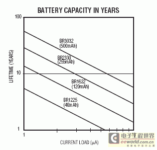

If an IC (SRAM or RTC) is going to be battery powered, there needs to be a match between the current demands of the IC, the expected lifetime, and the energy available in the battery. If the IC and battery are being purchased, the data sheet specifications will provide the information required to predict the lifetime of the battery as a function of the IC load. If the IC and battery are being purchased as a module, end users can rely on the module manufacturer to have the appropriate screens in place to ensure that the system lifetime meets the specification.
Figure 1. Lifetime based on amount of current being pulled from the battery.
Maxim has established screening limits on all of its battery-backed products that allow the available battery capacity to power the end part for specified lifetimes up to 10 years. In the case of Maxim ICs, the design and fab processes have been optimized to produce low-current demands. In the case of higher density SRAMs purchased from outside vendors, special screening is sometimes required to ensure that the module lifetime specifications are met. Figure 1 is produced from battery capacities reported by Panasonic. The four lines shown in Figure 1 represent four of the most common battery sizes (BR1225, BR1632, BR2330, and BR3032). The battery manufacturers' rated electrical capacity (in mAh) is shown with each battery size.

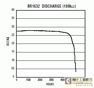

Maxim has chosen to use primary lithium coin-cell batteries in modules that require battery backup. These cells, which have a rated voltage of 3V and a typical in-system voltage around 2.7V, make them well suited as a backup supply. The voltage also remains stable during the battery discharge (Figure 2), so the voltage at the end of life is nearly the same as with a fresh battery. While a flat discharge curve is desirable for backup supply voltage, it does make predicting the remaining electrical capacity difficult.
Figure 2. The output voltage remains constant during discharge.
Primary lithium coin-cell batteries have a very predictable behavior. Distributions of such key parameters as open-circuit voltage or internal impedance are very tightly grouped. These tight distributions allow the battery manufacturers to set aggressive test limits in their process to ensure that abnormal cells are excluded from the population. These tight distributions also allow the user of the batteries to identify IC/battery systems that contain a defect. For example, since the voltage distribution and the voltage vs. battery load is very predictable, the battery voltage after a load has been attached can be an indicator of the load placed on the battery. If the battery load is the current demand of a well-behaved distribution of ICs, the resulting loaded voltages will also be tightly distributed. Any loaded voltage that is seen outside of the normal distribution is then an indication of an abnormal IC or battery. This result can be used to reject the resulting module as a potential reliability risk.

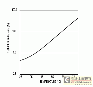

Because these batteries are being used in very low or zero-current applications, users also need to look for other possible mechanisms that will deplete any of the reactive components. One such mechanism is electrolyte loss through the crimp seal. This mechanism has been shown to be temperature-accelerated with an activation energy of approximately 1.0eV. At room temperature the batteries will exhibit an electrical loss rate of less than 0.5% per year, and this mechanism can safely be ignored. However, at elevated temperatures the loss rate of the electrolyte can become significant and must be considered.

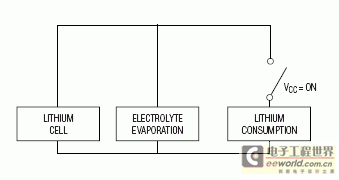

Because of the reactive components' balanced nature, it does not matter whether the electrical reaction consumes the electrolyte or it is expelled through the seal because of elevated temperatures. When the battery does not have enough electrolyte to continue the reaction, the battery will no longer provide current. Therefore, we recommend using a parallel model for lifetime predictions that considers the electrical demand and temperature when predicting the system lifetime (Figure 3). There are models that treat the electrical and temperature depletion legs as independent and predict a lifetime as if there were no interaction between the two components of electrolyte loss. Using such a model will overstate the true lifetime if the system is exposed to temperatures much higher than room temperature.
Calculating the lifetime of the battery is similar in concept to calculating the effective resistance of two parallel resistors. The user has control over whether the IC is consuming power from the battery or the system's power supply, so the current consumption leg is shown to include a switch. While the IC is being powered from the system power supply, the lifetime due to current consumption can be approximated as infinite.
The manufacturer of the IC/battery system has control over the selected components and manufacturing process. Properly selected components and manufacturing screens should result in adequate system-level lifetime. However, end users have control over the ultimate lifetime performance based on the actual use of the system. End users can control both legs of the model. The electrical load leg is controlled through the power-on duty cycle of the equipment. While system power is applied, the Maxim components include battery isolation circuitry that electrically isolates the battery and eliminates all current drain from the battery. Therefore, the electrical load leg of the reliability model is only active while the system is in battery backup. The system ambient temperature controls the temperatureaccelerated leg. Providing adequate cooling and proper component placement can help reduce the temperature exposure of the battery and, thereby, extend the system's lifetime.

Figure 4. The self-discharge rate increases as temperature increases.
