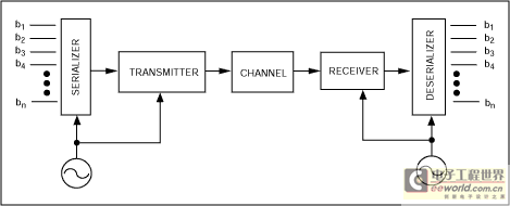

Figure 1 provides a basic diagram of a high-speed serial-communications link. Parallel data (bits b1, b2, b3,... bn) arrives at the transmission serializer at frequency ft. Within the serializer, data is converted from the parallel format to a serial format. A serial-bit stream is developed with a minimum bit rate equal to n x ft, where n is the total number of parallel data bits. The resulting frequency (bit rate) can be higher than ft depending on whether the data is encoded to meet channel requirements for bit error rate (BER) performance or to provide rich transition content at the receive-side CDR. Reed-Solomon forward-error correction (FEC) and 8B10B encoding are, respectively, each examples of channel encoding or creating rich transition content at the receive CDR. This serial data is then readied for transmission to the channel and sent through to the receiver, finally reaching the deserializer. This basic communications block applies to data whether it is transmitted through fiber, air, or across backplanes.
Figure 1. Clock and data recovery form the basis for high-speed serial communications links.
Timing (clocking) is critical in CDR applications. During system design, the designer determines how to drive data from a parallel format to a serial format for transmission and reception through the channel with pending channel distortion of the transmitted signal. Minimizing the effects of the design's degradation on the data signal is important for protecting signal-to-noise ratio and maintaining BER performance. For example, in digital-transmission schemes across backplanes, the system's jitter performance is extremely important as high-speed electrical signals traverse various lengths (FR-4 and the backplane), thus causing signal degradation in terms of signal-level and time-variant distortions.

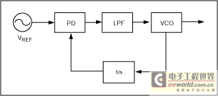

At the core of clock-data recovery is a phase-locked loop (PLL)-based circuit that in some cases could be digitally based. Figure 2 is the basic PLL block diagram that could be used in the serializer or transmission side of the communication link shown in Figure 1. The PLL block includes a phase-frequency detector (PD), filter (LPF), voltage-controlled oscillator (VCO), and a divide chain (1/n). The divide chain is used to provide comparable frequency inputs to the PD. In this manner, the VCO's output is phase-aligned to the very stable reference input, VREF. This PLL block's purpose is to multiply the reference frequency by a fixed amount (n), which would be the VCO's natural frequency. In most cases, VREF would be quartz based, providing a high degree of stability and accuracy with great phase-noise characteristics. Additionally, this reference may be temperature compensated or voltage compensated, depending on the required application or system requirements. In SONET-based applications, this reference may meet a certain stratum level (i.e., stratum levels 3, 3E, or 4).
Figure 2. Clock multiplication applications are driven by PLLs.

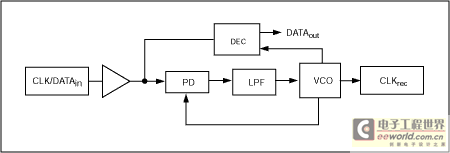

At the receive side, the CDR PLL block takes on a slightly different look to address the need to retrieve both clock and data. As shown in Figure 3, the combined clock/data signal comes into the PLL block through a buffer that feeds two distinct paths. One path feeds the data-decision (DEC) block while the second path feeds the clock-recovery blocks. The clock-recovery blocks look very much like Figure 2's PLL block minus the 1/n block. The recovered clock from the VCO is used as a sampling input to the DEC, a feedback to the phase-frequency detector, and also to feed system-timing requirements downstream. In the case of Figure 1, this recovered clock is divided down to the parallel-clock frequency to drive the deserializer block.
Figure 3. Modifications to the basic PLL block are used to implement CDR circuits.

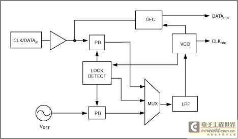

In some applications, a combination VCO/VCXO would be used. In Figure 4, VCO/VCXO allow for at least two benefits to the common CDR configuration. First, the addition of the VCXO allows fast regulation of the VCO frequency to match that of the expected clock/data signal. The VCXO frequency is chosen to match the expected clock frequency range. For example, a wideband VCO can require thousands of samples to lock onto the incoming data stream. The additions of the VCXO and lock-detection circuit ensure that the VCO maintains a certain operating frequency, and help provide a more predictable lock time in startup conditions. Second, the addition of the VCXO is helpful if the clock/data input has been lost over an extended period of time. In the absence of a clock/data signal, the system would refer to the very stable quartz-based oscillator (VREF) to provide holdover until the clock/data signal has been recovered from a loss of signal (LOS). Holdover is a specification that applies to the reference clock's ability to hold a certain accuracy over a certain period of time (for example, ±4.6ppm over 24 hours).
Figure 4. A modification on the basic CDR block provides easy locking on the incoming clock/data stream.
