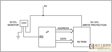

One way to accomplish this task is to use a second voltage monitoring device. Dallas Semiconductor manufactures the DS1233B, a 5V-5% voltage monitor in a 3-pin TO-92 size package. This 5% monitor drives an active low reset signal, RST-bar, as soon as it detects an out-of-tolerance condition. This active low signal can be used as an IRQ-bar input to a microprocessor, providing the microprocessor with an advanced warning that the power supply is falling, and giving it time to service the interrupt before the system's nonvolatile memory has been write protected. The following diagram illustrates this concept.
5V - 5% IRQ-bar Generation
You might wonder of what use the time between a 5% and 10% drop in a 5V power supply could possibly be to a microprocessor. After all, don't power supplies fall rapidly when they do go through a hard failure? The answer is, yes, of course they do. But, fortunately, microprocessors can service interrupts and process information even faster. All that is required is that the system's interrupt servicing software be configured so that it quickly identifies and services external interrupts. An example follows of how useful this time can be.

With this set of givens, how many instructions should the processor be able to execute between the 5% and 10% trip points on a 5V power supply?
1/25MHz = 40ns clocks
six clocks/instruction = 240ns per instruction
(4.75-4.00)/300 µs = 0.0025V/µs
5% - 10% drop = 0.25V; hence 5%-10% drop = 100µs
100µs/240ns per instruction = 416 instructions
Having 416 executable instructions at your disposal versus having none during a power down makes a big difference in saving 256 bytes of information or losing it, or in saving the state machine of the processor or losing it. In addition, the variables can be modified by design to give the processor even more time. The rate of fall of voltage of the power supply during a power failure can be slowed by adding capacitance. Processors requiring fewer than six clocks to execute an instruction can be used. In any case, using a DS1233B in conjunction with your NV SRAM requirements can give you the additional time you need to execute an orderly system shutdown, without corrupting your memory or allowing your microprocessor to run out of control.
