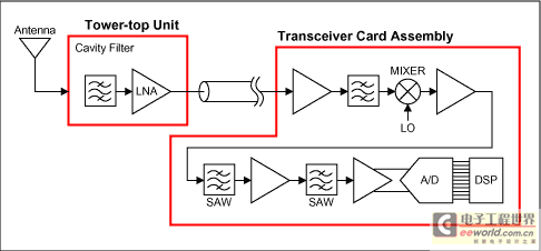

Cellular base station receivers work in the presence of high level blockers/interferers while being required to sense weak signals of interest at the antenna. The interferers are usually rejected by filters but only at an intermediate frequency (IF) after the first downconversion. The LNA and mixer preceding the IF filters are required to have high linearity (IP3) and low Noise Figure (NF).
A typical base station receiver featuring simplified blocks is shown in Figure 1. The receiver starts with the antenna featuring a tower-top very high-Q cavity-tuned filter, and an LNA located close to the antenna. A long coaxial cable connects the received signal to the transceiver. The transceiver unit has a cascade of LNA, low-noise mixer, SAW filters and IF amplifiers, leading to an analog-to-digital converter (ADC). The first mixer performs a conversion down to a typical IF of 70MHz–100MHz (CDMA 800/GSM 900) or 200MHz–300MHz (GSM 1800/GSM 1900/UMTS).
Figure 1. Basic blocks of a cellular base station receiver.

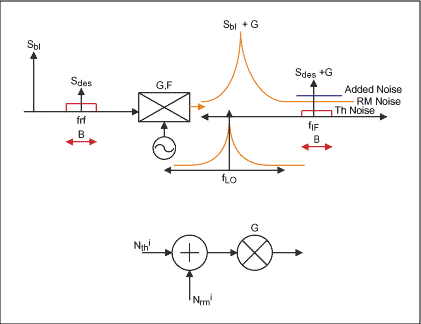

Reciprocal mixing happens in the presence of a strong RF signal at the RF port. This is an additional noise not accounted for during NF measurements. Reciprocally mixed noise Nrmi referred to the input can be evaluated at a specific blocker level Sbl. Given an LO noise floor into the mixer and a bandwidth B, reciprocally mixed noise at IF is
The phase noise is assumed flat if the interferer frequency offset is a sufficiently large offset from the desired signal. These two noise sources are independent and can be summed up as illustrated by Figure 4. The signal-to-noise ratio degradation from input to output in the presence of blockers can be expressed as

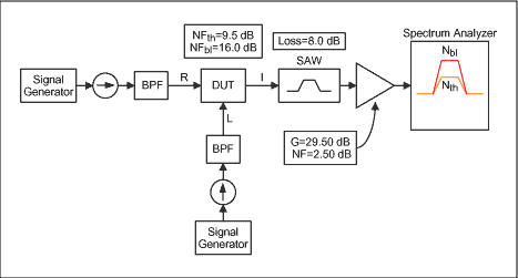

Equations 1 and 2 when substituted into 3, describes the effect of the LO noise floor, (in dBc/Hz) on the signal-to-noise ratio of the receiver. High linearity mixers typically require high LO drive levels and the noise floor of amplifiers can increase by an order of magnitude. Since reciprocal mixing impresses the LO noise at the IF port as defined by Equation 2, it is possible to measure the noise floor of the LO driver by measurements at IF. A set-up shown in Figure 5 can be used to measure the mixer noise under blocking conditions. The noise floor is measured under no signal and then under blocking conditions. The Nbl is composed of output thermal noise floor, Ntho and output reciprocal mixing noise, Nrmo altered by the SAW filter and IF amplifier. Ntho is determined from small signal noise (F) and gain (G) measurements.
Nrmo can be separated out of Nbl and the (dBc/Hz) of the integrated LO driver can be computed. Specifying the effective noise floor of integrated circuit mixers helps the system designer estimate the degradation of the Signal-to-Noise ratio (SNR) from Equation 3.
Figure 4. Representation of mixer noise as a sum of thermal and reciprocal mixing noise.
Calculation Example
MAX9993 is an active mixer designed for PCS/DCS/UMTS (1.7G–2.2G) applications. It has a typical gain of 8.5dB, an NF of 9.5dB, an IIP3 = 23.5dBm, a P1dB = 13.0dBm, operating with a local oscillator drive PLO between 0 and 6dBm . The input referred thermal noise, Nthi is -174 + 9.5 = -164.5dBm/Hz and the output thermal noise floor, Ntho is -174 + 9.5 + 8.5 = -156 dBm/Hz. The operating frequencies in this example are fIF=190MHz , fLO = 1800MHz and fRF = 1990MHz. Injecting a 5dBm blocker offset 25MHz from fRF (fbl=2015MHz) and using a 190MHz IF Filter (SAWTEK 855770) to reject the blocker at 215MHz, Nbl is measured at -127dBm/Hz with an Agilent E4404B spectrum analyzer. Without the blocker the noise floor of the set-up is measured at Ntho = -134dBm/Hz. The IF amplifier used in the set-up has a gain of is 29.5dB and NF of 2.5dB. The measured Ntho agrees with the calculation using the gain and NF of the blocks in the experimental set-up.
Figure 5. Experimental set-up to measure noise under blocking conditions and deducing .

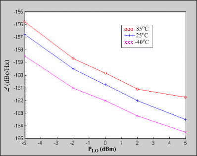

Figure 6. Local oscillator noise () indBc/Hz versus input local oscillator drive power into MAX9982 as a function of temperature.
The increase in noise floor in the presence of a blocker is attributed to the degradation in signal-to-noise ratio output of the mixer from Ntho to Nbl. The noise floor (Nbl) measured by the spectrum analyzer has noise contributions from thermal, reciprocal mixing noise, SAW and IF amplifier. The mixer's effective NF is increased from 9.5dB to 16dB for cascaded block analysis to account for the measured total output noise power. From the composite noise (Nbl), the reciprocally mixed noise Nrmi can be extracted by using the Equations developed in the mixer noise section. The signal-to-noise degradation represented in Equation 3 is 16dB. Solving for Nrmi in Equation 3 results in
The input-referred reciprocal mixing noise Nrmi = 15dBm/Hz - 174dBm/Hz = -159dBm/Hz. Since a 5dBm blocker is used, is -164dBc/Hz. This is well below the GSM requirement of -151dBc/Hz.
The LO noise defined as a signal-to-noise ratio (dBc/Hz) varies with the LO drive as the drive signal is limited by the LO buffers. This is illustrated in a second example.
The MAX9982 is a cellular CDMA/GSM band (825MHz–915MHz) high-linearity mixer with an input IP3 > 26dBm, a gain of 3dB and an NF = 11dB. This mixer is capable of operating with an LO drive ranging from -5dBm to +5dBm. Most of the specifications are invariant with the drive signal. Figure 6 shows a plot of (dBc/Hz) as a function of the drive-level. The set-up used for this measurement is identical to the one in Figure 5. A 86.6MHz GSM IF filter from SAWTEK (854823) is used to attenuate the blocker signal at the IF (5dBm at the DUT).
