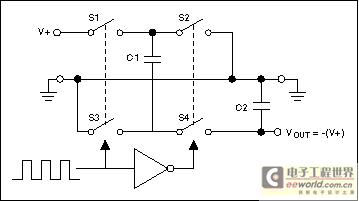

Charge-pump voltage converters use ceramic or electrolytic capacitors to store and transfer energy. Although capacitors are more common and much cheaper than the coils used in other types of DC/DC converters, capacitors can't change their voltage level abruptly. A changing capacitor voltage always follows the exponential function, which imposes limitations that inductive voltage converters can avoid. On the other hand, inductive voltage converters are more expensive.
Capacitive voltage conversion is achieved by switching a capacitor periodically. Passive diodes can perform this switching function in the simplest cases, provided an alternating voltage is available. Otherwise, DC voltage levels require the use of active switches, which first charge the capacitor by connecting it across a voltage source and then connect it to the output in a way that produces a different voltage level.
A common integrated circuit using this principle is the ICL7660, which could be called the prototype of the classic charge pump. It integrates switches and the oscillator so that the switches S1, S3 and S2, S4 work in alternation (Figure 1). The configuration shown inverts the input voltage. With a slight change in the external connections, it can double or divide the input voltage as well.
Figure 1. These essential components illustrate the mechanics of charge-pump operation.
Closing S1 and S3 charges the flying capacitor (C1) to V+ in the first half cycle. In the second half, S1 and S3 open and S2, S4 close. This action connects the positive terminal of C1 to ground and connects the negative terminal to VOUT. C1 is then in parallel with the reservoir capacitor C2. If the voltage across C2 is smaller than that across C1, charge flows from C1 to C2 until the voltage across C2 reaches -(V+).
An integrated fixed-frequency oscillator drives the periodic switching. This circuit has no output regulation, and the switching frequency remains constant for all loads. Thus, the output-voltage variation depends strongly on the load. With no load, the output voltage corresponds to the negative input voltage: VOUT = -(V+). As the load increases, VOUT decreases. Output current for the ICL7660 is therefore limited to about 10mA; this is partly due to its low oscillator frequency, and partly due to its integrated analog switches, which are far from ideal. These switches in the "on" state exhibit several ohms of on-resistance. A detailed calculation of the resulting power dissipation will be shown later.

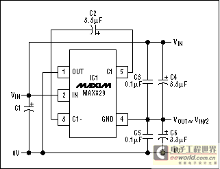

As an example, consider a circuit designed to divide the input voltage by two and double the output current. It offers advantages over linear regulators (which usually convert power into heat) and applications that require a limited output current. A 4mA to 20mA interface, for instance, often provides a relatively high output voltage but a limited pre-set output current. Other applications include the many op amps and µCs that now operate with very low supply voltages. In those circuits, dividing the supply voltage by two theoretically divides the power consumption by four.
The configuration of Figure 2 generates a regulated VOUT (= VIN/2) using the capacitive voltage divider C3, C4 and C5, C6. By switching the flying capacitor (C2) alternately between upper and lower halves of this divider, the IC counterbalances any load-dependant voltage differences. The circuit's switching frequency is 35kHz, and its quiescent current is only 36µA. When load currents exceed 1mA, the circuit efficiency exceeds 90%. Given very small load currents (below 100µA), however, even this low 36mA quiescent current leads to a reduction in conversion efficiency. This switched-capacitor configuration provides better regulation than a simple resistive voltage divider can and higher efficiency than that obtained from a simple combination of a voltage divider and an op-amp buffer. The IC specification limits VIN to 5.5V maximum.
Figure 2. With the connections shown, this inverting charge-pump IC divides the input voltage by two.

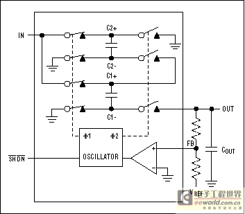

Many applications need an additional negative voltage such as -5V. Such a voltage can be generated with a regulating charge-pump inverter (MAX868) and a few external components (Figure 5). When charging, the left-hand switches close and the right-hand switches open. Both flying capacitors are charged in parallel, and the load is serviced entirely by charge stored in the output capacitor. During discharge, the switches reconfigure to connect the flying capacitors in series. When connected to the output capacitor, they then transfer charge as required to maintain output-voltage regulation.
Figure 5. Internal components illustrate the operation of this regulated charge-pump inverter (MAX868).
The internal oscillator frequency (450kHz) is sufficiently high to ensure small external capacitors and high output current. Controlled by a comparator, the oscillator becomes active only when the output voltage is lower than its threshold. This regulation enables the circuit to provide constant output voltages as high as -2VIN. At the same time, it draws minimum quiescent currents at light loads.
