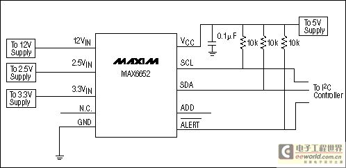

Figure 1. Circuit of Example 1. All input voltages are at the nominal values.
Table 1. Output Codes and ±5% Limits for the MAX6652 Used to Monitor the Nominal Power-Supply Voltages
Monitored Voltage MAX6652 Input Nominal Output Code -5% Limit +5% Limit
12 12VIN 192 182 201
5 VCC (5VIN) 192 182 201
3.3 3.3VIN 192 182 201
2.5 2.5VIN 192 182 201

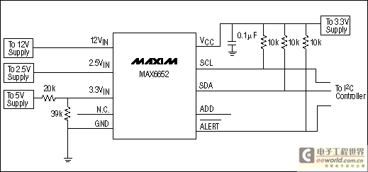

Monitoring 5V is more difficult in this example. The 5V can't be applied directly to the 3.3VIN input, because that input is scaled for a maximum input voltage of 4.383V. A resistive voltage divider, as shown in Figure 2, attenuates the 5V supply so that it can be measured at the 3.3VIN input. Using a 39kΩ and a 20kΩ resistor, 5V applied to the divider results in a voltage at the 3.3VIN pin of:
VIN = 5V × 39kΩ/59kΩ = 3.305V
This produces a code equal to 192, so the ±5% thresholds are at 182 and 201.
The limits for the 12V and 2.5V inputs are the same as in the first example.
Figure 2. Circuit of Example 2. The same as Example 1, but the MAX6652 operates from a 3.3V supply, which necessitates attenuating the 5V supply so that it can be monitored at the 3.3VIN input.
Table 2. Output Codes and ±5% Limits for the MAX6652, Monitoring the Nominal Power-Supply Voltages but with a 3.3V Supply Voltage for the MAX6652
5 3.3VIN (attenuated) 192 182 201
3.3 VCC (5VIN) 126 120 133

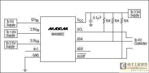

Figure 3. Circuit of Example 3. This circuit is used in a low-voltage system to monitor 5V, 3.3V, 2.5V, and 1.8V. The MAX6652 operates from a 3.3V supply. The 12VIN input monitors the 5V supply, and the 3.3VIN input monitors the 1.8V supply.
Table 3. Output Codes and ±5% Limits for the MAX6652 in a Low-Voltage System, Monitoring 5V, 3.3V, 2.5V, and 1.8V
5 12VIN 80 76 84
1.8 3.3VIN 104 99 109

This is an alternative to Example 3. In this example, the1.8V supply is monitored at the 2.5VIN input instead of at the 3.3VIN input, and the 2.5V supply is monitored at the 3.3VIN input. This improves the measurement resolution for the 1.8V supply, while making the resolution for the 2.5V supply somewhat worse relative to Example 3.
The 3.3V supply voltage is monitored as in Examples 2 and 3.
The 12VIN pin monitors the 5V supply as in Example 3.
The 3.3VIN pin will be used for monitoring the 2.5V supply voltage. With 2.5V applied to this input, the output code (rounded down) will be as follows:
192 × 2.5/3.3 = 145
For alarms 5% above and below the 2.5V nominal power-supply voltage, we have (rounded down):
high limit = 192 × 2.5V/3.3V × 1.05 = 152
and
low limit = 192 × 2.5V/3.3V × 0.95 = 138
The 2.5VIN pin will be used for monitoring the 1.8V supply voltage. With 1.8V applied to this input, the output code (rounded down) will be as follows:
192 × 1.8/2.5 = 138
high limit = 192 × 1.8/2.5 × 1.05 = 145
and
low limit = 192 × 1.8/2.5 × 0.95 = 131

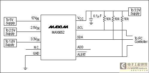

Figure 4. Circuit of Example 4. This circuit is an alternative to the low-voltage circuit in Example 3. Monitored voltages are still 5V, 3.3V, 2.5V, and 1.8V, but the inputs to the 3.3VIN and 2.5VIN pins are swapped to give better resolution when measuring the 1.8V supply.
Table 4. Output Codes and ±5% Limits for the MAX6652 in the Alternative Low-Voltage System, Monitoring 5V, 3.3V, 2.5V, and 1.8V
Note that the 1.8V input voltage produces a larger ADC code, resulting in a higher-resolution measurement.
5 12VIN 80 76 84
2.5 3.3VIN 145 138 152
1.8 2.5VIN 138 131 145
