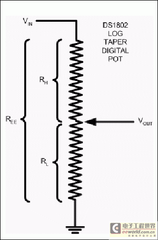

dB attenuation is defined as 20 X LOG(VOUT/VIN).
The desired ratiometric output is defined as:
RL/REE = RL/(RL + RH) = VOUT/VIN
with RH = defined as the high-side of the DS1802, RL defined as the low side of the DS1802, REE defined as the end-to-end resistance, and VOUT and VIN defined as the output and input signals, respectively, as shown in Figure 1.
Figure 1. DS1802 block diagram (one potentiometer shown).
If we know the dB attenuation for a given potentiometer setting, we can calculate the ratiometric output by solving for VOUT/VIN or:
the Ratiometric Output = INVERSE LOG10(dB attenuation/20). If one wanted to calculate the output signal ratiometrically as a function of the input in a spreadsheet like Excel, no function for the inverse log function exists. As the INVERSE LOG function of X can be calculated as 10X, in Excel the power function can be used as follows: = (10)^(dB/20), where dB can be a value stored in another cell in the spreadsheet.

This ratiometric output can also be expressed as the ration of RL to REE (=RL/REE) so, as an example, the value of RL at a wiper setting of -21 dB would be 0.08913 x REE.
