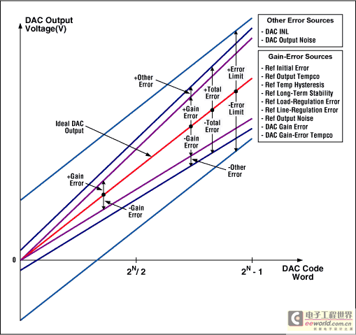

Output Error and Accuracy Definitions
We define output error as the deviation from an ideal output voltage that would be provided by a perfect voltage reference and DAC. It's important to note that we are addressing absolute accuracy in this article, meaning that everything is referenced to an ideal DAC output-voltage range. For example, a 12-bit DAC code 4095 should produce an output of 4.095V with a reference voltage of 4.096V; any deviation from this is an error. This is in contrast to relative accuracy, where the full-scale output is defined more by the application than by an absolute voltage. For example, in a ratiometric system where an ADC and a DAC with equal resolution share a reference, it may not matter (within reason) what the actual reference voltage is, as long as the DAC-output and ADC-input voltages are nearly equivalent for a given digital code.
Output error is often specified as a one-sided value (in LSBs at the DAC resolution), but it actually implies a double-sided error (Figure 3). For example, a 12-bit DAC with a 4.096V output range has an ideal LSB step size of 4.096V/4096 = 1mV. If the specified output error in this case is 4LSBs at 12-bit resolution, this means the DAC output at any code could be ±4LSBs (or ±4mV) from the ideal value. We define accuracy in terms of how many actual bits we have at our disposal to reach a desired output voltage with at most 1LSB of error:
Accuracy = DAC Resolution - log2(Error)
In our example, we effectively have 10 bits (12 - log2(4)) of accuracy, because we can only get to within 1LSB at 10-bit resolution (±4mV = ±4/4096 = ±1/1024) of any given ideal DAC output value.
Figure 3. DAC transfer function and output error (zero offset assumed).
There are several sources that contribute to output error, but some (such as DAC offset) are ignored because they are not relevant to the reference-voltage selection process. Voltage-reference error sources that are considered include initial error, tempco, temperature hysteresis, long-term stability, load and line regulation, and output noise. DAC error sources include INL, gain error, gain-error tempco, and output noise.
Although the target error applies over the entire DAC code range, most of the error sources mentioned above cause an effective gain-error variation that is largest near the full-scale (highest DAC codes) of the transfer function (Figure 3). Gain errors are reduced with decreasing DAC code value; these errors are halved at midscale, and they virtually disappear near code zero, where offset error dominates. Error sources that do not exclusively affect the gain error and apply equally over most of the DAC code range include DAC INL and output noise.

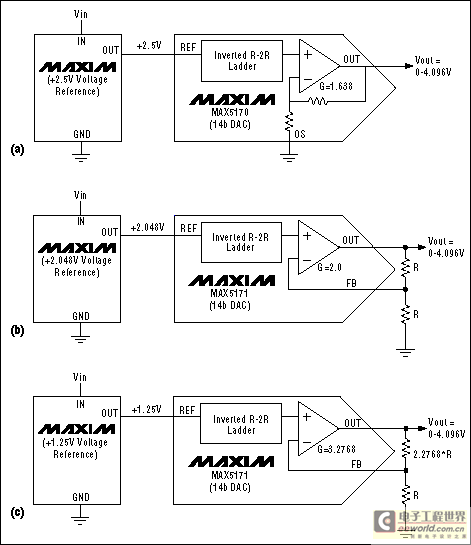

Design B: High Absolute Accuracy and Precision
A 2.5V reference is chosen for the Design-B example, as the MAX5170 gain is fixed at 1.638 and a final output-voltage range of 0-4.096V is required. If a lower reference voltage is desired for Design B, a MAX5171 DAC could be used and its output force/sense gain could be set higher than 1.638 with external resistors, as shown in Figure 4. Note that the minimum VDD level is 4.95V, so the highest reference voltage we could use is 4.95V - 1.4V = 3.55V, as the DAC reference input is limited to (VDD - 1.4V)*.
*This limit applies to all DACs mentioned in this article.
Figure 4. Design-B reference options: (a) 2.5V (chosen), (b) 2.048V, (c) 1.25V.

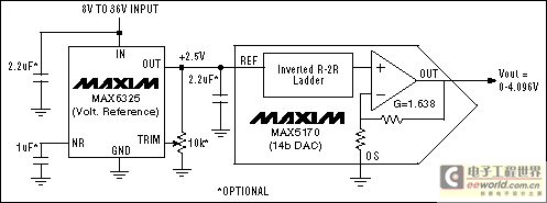

Because Design B has such challenging accuracy requirements, the MAX6225 and MAX6325 buried-zener references are the initial candidates because they have such low tempcos, excellent long-term stability, and low noise. These devices also have very good initial accuracy, but this is a moot specification in the case of Design B, as gain errors caused by the DAC and the voltage reference are calibrated out. The MAX6225 and the MAX6335 source 15mA, so driving the MAX5170 DAC reference input (2.5V/18k ~ 140µA max) is not an issue. The MAX6325 is chosen because it has the only tempco (70°C × 1ppm/°C = 70ppm max) that puts us beneath the overall 122ppm accuracy requirement (2LSB @ 14 bits = 2/214 = 2/16384 = 1.22 × 10-4 = 122ppm) while leaving margin for the other error sources. If we relax the Design-B accuracy requirements slightly, the MAX6225 A-grade device (2ppm/°C max tempco) would allow us to cut the reference cost by more than half.
A 12V supply is conveniently present in the Design-B example, allowing the use of the MAX6325, which needs an input voltage of at least 8V. If 8V (or higher) is not available in the system, the MAX6166 (A grade) or MAX6192 (A grade) bandgap-based references could be considered, but a slight relaxation of the system specifications would be required.

Force/sense gain set to 1
Fixed gain = 1.638
Fixed gain = 2
Fixed gain = 1.638

Reference Voltage
2.5V
2.5V
2.048V
1.25V

Not critical due to gain calibration

Each example is analyzed, focusing on the specifications that apply to that particular design. The results of this analysis, along with the results of the previous section, are summarized in an error budget in Table 5.
It is most convenient to do the error-budget accounting in ppm, although this could be done equivalently in other units such as %, mV, or LSBs. It's important to apply the proper scaling and to use the proper normalization factor to get the correct error values. Reference error terms can be equivalently calculated relative to the reference voltage or the DAC output voltage. For example, if we assume a reference error of 2.5mV (noise, drift, etc.) and a reference voltage of 2.5V, we get the following:
Reference Output Error = 106 × 2.5mV / 2.5V = 1000ppm
If we assume that the DAC output amplifier has a gain of 2.0, both the error and the reference voltage are scaled, so we get the same result at the DAC output (5V full-scale range):
DAC Output Error = 106 × (2.5mV × 2) / (2.5V × 2) = 1000ppm

We will now review the relevant MAX5304 DAC specifications that impact accuracy at or near the upper end of the code range. The DAC INL value of ±4LSB (at 10 bits) is used directly. Treating it as a single-sided quantity, as with the other error terms in our analysis, we arrive at a value of 3906ppm (106 × 4/1024). Similarly, the DAC gain error is specified as ±2LSB and results in an error of 1953ppm (106 × 2/1024). The final MAX5304 DAC specification to be considered is gain-error tempco, which gives us a typical error of 70ppm (70°C × 1ppm/°C). The DAC output noise is not specified for the MAX5304, so it is ignored, most likely without adverse consequences in this 6-bit-accurate system.
When all of the error sources are added together, we obtain a worst-case error of 15596ppm, which just barely meets our target-error specification of 15625ppm. When confronted with this marginal situation, we can rationalize that we will probably never see an error of this magnitude, because it assumes worst-case conditions for most parameters. The root sum square (RSS) approach gives an error of 7917ppm, which is valid if the errors are uncorrelated. Some error sources may be correlated, so the truth probably lies somewhere between these two numbers. But regardless of the approach, the Design-A requirements have been met.

The initial error of the A-grade MAX6225 is 0.04% or 400ppm, which exceeds Design B's entire 122ppm error budget. Because this application has gain calibration, virtually all of this reference initial error can be removed, assuming the calibration equipment has sufficient (~1µV) accuracy and the trim circuit has enough precision. The tempco contribution is calculated as 70ppm (70°C × 1ppm/°C), and the typical temperature hysteresis value of 20ppm is used directly. The long-term stability specification of 30ppm is also used rather than a more conservative number, because the instrument in this application has an initial burn-in as well as an annual calibration.
Applying the same assumptions that were used in Design A, we find Design B's reference output current variation to be 140µA (coincidentally, the same number as in Design A). This leads to the following load-regulation-error calculation:
Load-Regulation Error = 140µA × 6ppm / mA ~= 1ppm (max)
The power supply is specified as being constant in this application, so the line regulation is assumed to be 0ppm. Note that it would be <1ppm even if the power supply weren't constant, as long as it remained within the specified 4.95V to 5.05V range, because the MAX6325 line-regulation specification is 7ppm/V max.
Because the bandwidth for Design B is specified as DC to 1kHz, we need to consider both the 1.5µVp-p low-frequency (1/f) noise and the 2.8µVRMS broadband noise specified from 0.1Hz to 10Hz and 10Hz to 1kHz, respectively. Using the same crude RMS to peak approximation as Design A, and adding the two peak noise terms together, we get a total noise estimate of 2ppm at the reference output ([[0.75µV + 2.8µVRMS × √2]/2.5V] × 106). Notice that this is the same value we would obtain if we calculated it at the DAC output, because the equation would be multiplied by 1.638/1.638 to rescale everything to 4.096V. It's worth mentioning that the peak-noise-sum method used here is fairly conservative, yet the total error contribution is still relatively small. An RSS approach is probably more accurate, because the two noise sources are most likely uncorrelated, but this smaller value would be even more "in the noise" (pun intended) compared to the peak-value approach.
All that remains for the Design-B analysis is to include the DAC error terms. The INL for the A-grade MAX5170 DAC is specified as ±1LSB, which is 61ppm and exactly half of our 122ppm error budget of ±2LSB at 14 bits. The DAC gain error is specified as ±8LSB worst-case, but this error is removed completely by the gain calibration mentioned earlier. The calibration works as follows: The DAC is set to a digital code where the ideal output voltage is known (for example, decimal DAC code 16380 should produce precisely 4.095V at the output). The reference voltage is then trimmed until the DAC output voltage is at this exact value, even if the reference voltage itself is not 2.500V. The MAX5170 DAC does not list a gain tempco, although the gain error is specified over the operating-temperature range. Because the gain error is calibrated out at only one temperature, Design B should be tested to ensure that the gain does not drift excessively over temperature. The final consideration is the MAX5170 DAC output noise, whose typical peak noise is roughly estimated as 1ppm ([106 × √(1000Hz × π/2) × 80nVRMS/√Hz × √2]/4.096V).
In the end, the final worst-case accuracy is 184ppm (~ ±3LSB at 14 bits), which doesn't quite meet our accuracy target of 122ppm, whereas the RSS accuracy is acceptable at 100ppm. Based on these numbers, we consider the design a success, because it has illustrated the important points and is close to the target accuracy with several conservative assumptions. In a real-world application, this design could be accepted as is, or the accuracy requirements could be loosened slightly. Alternatively, a more expensive reference could be used if this design were not acceptable.

  • The system designer often has multiple reference-voltage and DAC gain choices to satisfy a given DAC output-voltage range.
  • Consider all error sources, not just initial error (which is important in some designs but not critical for others, such as those with gain calibration).
  • Reference and DAC tempcos can be major error contributors. Check the actual required operating-temperature range, because slight reductions can decrease the error contribution from these parameters significantly.
  • A common trade-off is the higher price of a reference with tight initial accuracy versus the trimming cost in product manufacturing.
  • Examine the accuracy requirements carefully to make sure they are correct before selecting unnecessary, more expensive components or reworking a design that has marginal performance. It is generally very difficult (and expensive) to achieve a high level of absolute accuracy, especially at 12 bits and above.
  • Worst-case or RSS analysis can be used to quantify the error, but it's ultimately up to the designer to determine if a given design is accurate enough.
