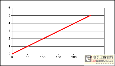

Circuit 1 is a non-inverting gain configuration using the EPOT as a variable resistor. In this circuit, the wiper is connected to one side of the EPOT effectively shorting out the (1-N) × Re side of the device. As a result, the feedback current flows through wiper and the portion of the EPOT correlating to N × Re. This circuit has a nice linear gain adjustment curve with respect to N, but some of the EPOT's characteristics give this circuit a few disadvantages.
Figure 1a. Circuit 1.
One disadvantage is that because the feedback current flows through the wiper, its resistance (and that resistance's variance with temperature) as well as its maximum current rating (typically about 1mA) may limit the applications for this circuit. Another disadvantage is that the end-to-end resistance, Re, is a part of the gain equation causing the ±25% tolerance of Re to contribute up to a ±25% variance in the gain. Mathematically, the maximum possible contribution of a 25% error in Re to the overall gain is 25%. Of course, as the Re/Ri term in the gain equation becomes smaller and the "1" term begins to dominate the gain, the error as a function of the tolerance of Re becomes smaller.
Figure 1b. Gain of circuit 1 with Re=50k and Ri=10k.
Circuit 1 is suited for cost sensitive systems that can live with the somewhat loose tolerance in overall gain. As with many of the circuits seen here, this includes circuits like volume or brightness control where the user is going to iteratively adjust the circuit according to personal preference. Another useful application would be in an automatic gain control circuit where either digital or analog automatic gain control is used to make a gain compensation for a system output. For example, an APD circuit may use either digital or analog automatic gain control to control the biasing of the photodiode with high accuracy. In such a circuit, the automatic gain control technique takes the tolerance of Re (in the EPOT) out of the equation.

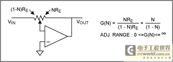

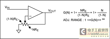

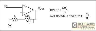

Another possible configuration is shown in circuit 2. Here the wiper is connected to the high impedance input of the op-amp using the EPOT as a sort of variable voltage divider. By connecting the wiper to this high-Z input, the only current that flows through the wiper will be the input bias current of the op-amp. This current is typically very small (usually between pA and uA) so that any variance in the several hundred Ω resistance of the wiper will be negligible.
Figure 2a. Circuit 2.
In addition, the Re terms on the top and bottom of the gain equation cancel out leaving just a function of N. This removes the impact of end-to-end resistance from the gain equation altogether.
Unfortunately, this circuit has one big disadvantage. The gain adjustment is non-linear with respect to N. A plot of G(N) for circuit 2 is shown in Figure 2. By deriving the slope of G(N) as G'(N) = 1/(1-N)², it can be seen that the slope is also a function of N and therefore isn't even piecewise linear over a select range of N. In the section on Inverting Configurations, several ways to use this circuit and counteract its inherent non-linearity are discussed.
Figure 2b. G(N) for circuit 2.
Circuit 2 is useful in many of the same systems mentioned for circuit 1 (i.e., audio control, brightness control, AGC loops etc.). In addition to the applications seen in circuit 1, the lack of a dependence on Re and the resistance of the wiper makes this an excellent circuit for calibration adjustments. Also notice that in circuit 2, the gain steps are heavily concentrated from 1 to 2, but that much higher gains are still possible. While rare, some calibration applications may call for a period of high gain followed by a period of very finely tuned low gain. An example might be in the measurement of air pressure in a blood pressure cuff. In such a system, when inflation is initiated, the pressure is very low and the measurement is primarily used to detect faults (high gain). Once the cuff is fully inflated the measurements are used to detect minute changes in cuff pressure vs. time. The AGC loop using circuit 2 can be used to optimize ADC dynamic range during blood pressure measurement. The calibration is done at production to compensate for mechanical and sensor deviations.

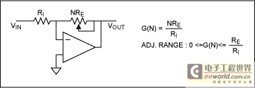

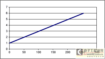

The principles used in the non-inverting configurations can also be applied to inverting op-amp circuits. In circuit 3 the gain is simply the apparent resistance in the feedback path over the input resistance.
Figure 3a. Circuit 3.
This circuit has the benefit of having a linear gain adjustment as a function of N, as shown in Figure 3b.
Figure 3b. G(N) for circuit 3 with Re=50k and Ri=10k.
This circuit has the same disadvantages as those seen in circuit 1. It will have a slightly different dependence on the tolerance of Re because the gain equation is slightly different; the gain will vary as much as ±25% as the tolerance on Re varies. This circuit is going to be useful in inverting applications similar to those already mentioned for circuits 1 and 2.

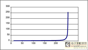

Just like circuit 2, circuit 4 is not susceptible to the disadvantages mentioned for circuits 1 and 3. Because the Re terms on the top and bottom cancel each other out of the gain equation, the gain depends only on N. As a result, errors in the absolute resistance are effectively cancelled out in circuit 4, making it attractive for use with EPOTs that have a wide tolerance for the end-to-end resistance. In addition, an op-amp's input bias current is usually in the range of pA to uA. With so little current flowing through it, the wiper's resistance, drift with temperature and maximum current spec will not be a factor in this circuit.
Figure 4a. Circuit 4.

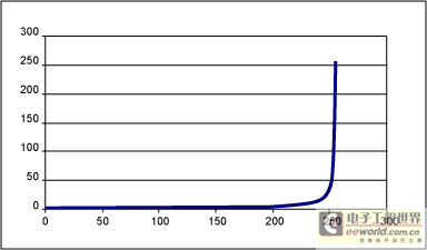

The gain for this circuit is shown in Figure 4b. This circuit has the same drawback as circuit 2, its gain adjustment is going to be non-linear over the entire range of N. This inherently non-linear gain adjustment does not prevent this from being useful. This circuit will fit very well where an inverting amp is needed in the same applications as for circuit 2. For example, this might fit well in applications with user feedback, such as volume control or display brightness control circuits and also in calibration circuits or AGC circuits.
Figure 4b. G(N) for circuit 2 with a 256 tap EPOT.
However, some systems require even gain steps as a function of N. Below, two approaches are given for linearizing the gain of circuit 4.

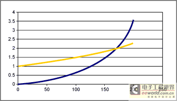

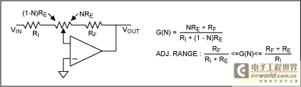

In circuit 5, resistors have been added to the input path and the feedback path to "flatten out" the plot of the gain. In the plot of G(N) for this circuit, both its gain and the gain for circuit 4 are shown. The last 50 points have been omitted for clarity. This plot shows how the gain curve can be "flattened" at the expense of adjustment range.
Figure 5a. Circuit 5.
By adding resistors to both the input path and the feedback path, the minimum gain (where N=0) is raised and the maximum gain (where N=1) is lowered effectively compacting the available gain range. For example, in the plot shown the gain can be adjusted from 1 to 3 rather than from the 0 to 255 corresponding circuit 4.
Figure 5b. G(N) for circuit 5 with Ri=50k and Rf=100k (yellow). G(N) for circuit 4 is also shown (blue) for illustration.
This circuit also has the advantage of connecting the wiper to the high impedance op-amp input. Additionally, while the gain is not going to be perfectly linear like circuit 3, any effects the wiper's characteristics have on performance are taken out of the equation by greatly reducing the current through the wiper.
The big drawback to this circuit is that by adding Ri and Rf to the gain equation, the Re terms that were cancelled out in circuit 4 cannot be cancelled out here. One advantage of circuit 4 was that the Re terms in the gain equation cancelled each other out making the large tolerance of the end-to-end resistance irrelevant. For circuit 5 however, the Re terms cannot be cancelled out and deviations in the end-to-end resistance of the EPOT will affect the overall gain. The exact impact of deviations in the end-to-end resistance will depend on the ratio of Rf and Ri to Re. Making Rf and Ri large with respect to Re can minimize this impact, but will hamper the available adjustment range. In the example used for the plot of Figure 5b, a 25% increase in Re makes the minimum gain 0.88 rather than 1 and the maximum gain 3.25 rather than 3. A 25% decrease in Re makes the minimum 1.14 and the maximum 2.75.

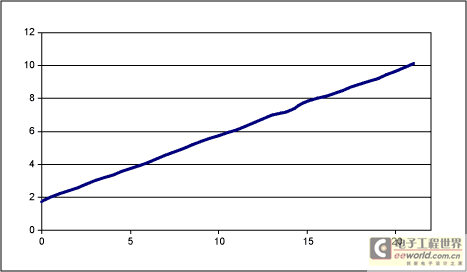

A Design Example using Software Compensation to Linearize Gain
Most systems use a microcontroller to control the setting of the EPOT and therefore, the gain of the circuits here are usually controlled by software. In addition, while this article has used 256 step EPOTs for illustration, many systems only need 20 to 30 steps in the gain. Using software and a 256 step EPOT configured as shown in circuit 4, 20 to 30 steps of linear gain adjustment curve can easily be accomplished by using software compensation. A design example is shown here for a software compensated, inverting, and adjustable gain op-amp circuit.
The goal for this design is to have the following performance characteristics:
  • No current through the wiper.
  • A linear gain adjustment curve with better than 3% error. This is better than 1 LSB for a 32 tap EPOT.
  • Eliminate any dependence on absolute resistance Re.
To meet these design requirements, the following steps are offered. The basic idea is to pick the optimal number of gain steps between the desired minimum and maximum gain.
1. Pick a maximum and minimum gain. For this example a minimum of 2 and a maximum of 10 was chosen. Empirical testing shows that this method works pretty well for gains of up to about 20.
2. Find the actual possible maximum gain. The actual maximum gain is the gain that will be a solution to the equation
G(n) = n/(256 - n) n=0,1,2...
For this example, solving for a G(n)=10 gives n=232.72. Since only whole values of n are available, select n=233. The actual maximum gain is then G(233)=233/(256 - 233) = 10.13.
3. Get the slope m. The slope m could also be called the step size, as it will correlate to the gain steps between values of n. The recommended method is to use the average gain change over the last 5 values of n in the range of interest. In other words,
m= [G(nmax) - G(nmax -5)]/5
The decision to use the last 5 values is somewhat arbitrary and the designer is encouraged to experiment with other values. For this example, m=[G(233) - G(228)]/5=0.398.
4. Find the actual possible minimum gain and the number of steps. In order to be certain that the minimum gain is a possible solution to the line being created, the equation for y=mx+b can be solved. Since a discrete system is being used, simply find the number of steps between the max gain and the expected min gain (chosen in step 1), where
max steps = [G(nmax) - Gmin]/m.
For this example, max steps = [10.13 - 2]/0.398=20.4. Once again, only a discrete number of steps is available, so round up the result to increase the maximum number of steps to 21. Therefore, the actual minimum gain is going to be 21 steps of 0.398 each less than the maximum gain or
Gmin= G(nmax) - (max steps) × m = 10.13 - (21 × 0.398) = 1.772.
5. Get the intercept b. The value for b or the y intercept is simply the min gain.
The result is the equation
f(x)=0.398x + 1.772, where x=0,1,2...21.
This equation can be used to find the values of n or the EPOT settings that are used to get this straight line gain curve. This is done by solving G(N) = n/(256 - n) = f(x). The actual implementation is up to the designer, but basically the options are to either use a lookup table or to solve for the value of n on the fly.
A plot of the gain for this example is shown below as a function of x.

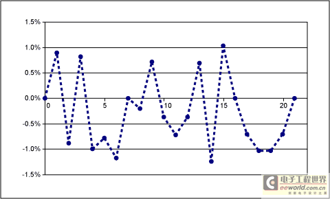

The deviation from the ideal straight line is plotted below as a percentage.
Figure 7. Deviation from ideal as a percentage.
