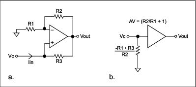

The right side of the circuit (Figure 2a) is easily simplified. Its defining equations are
Note that the input current equals the input voltage divided by a negative resistor. The negative resistor just changes the direction of the input current. The corresponding equivalent circuit is inferred by inspection (Figure 2b).
Figure 2. In Figure 1, the right-hand side (a) can be simplified to an equivalent circuit (b).

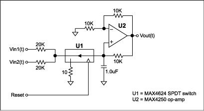

The circuit of Figure 4 is a practical Deboo integrator with two inputs and a reset. The input R is simply the parallel combination of the two 20kΩ resistors. The circuit can sum any number of inputs as long as the parallel combination of the input resistors equals the required R, which in turn equals R1 × R3/R2.
Figure 4. This practical implementation of a Deboo integrator has two analog inputs and a reset input.
A single-pole/double-throw analog switch was chosen to perform the reset function. That configuration (vs a single switch across the capacitor) eliminates any reset offset error due to voltage division between the input R and on-resistance in the switch. To prevent the switch from going into its short-circuit-protection mode during reset (which prolongs the reset), voltage across the MAX4624 is limited to less than 0.6V by adding 10Ω in series with the MAX4624. (For capacitors of 0.1µF or less, this voltage-limiting resistor is unnecessary.)
Many parameters should be considered when designing an integrator. Fast integrators require wideband op amps with low bias current. Very slow integrators require closely matched resistors, op amps with extremely low bias current, capacitors with low leakage current, and a physically clean board layout. Polypropylene, polystyrene, or teflon are the dielectrics of choice for capacitors with low leakage and low dielectric absorption.
To implement a single-input integrator, the four resistors can have the same value. Quad equal-value resistor packs with ratio tolerances down to ±0.01% are available from Caddock Electronics, but less demanding requirements can allow the use of four discrete ±1% resistors. Choose the reset switch carefully, because its off-leakage is integrated by the capacitor. The switch on-resistance must be low enough to allow the capacitor to be reset as quickly as necessary. Finally, charge injected by the switch during turn off must be sufficiently low to avoid an objectionably large offset on the capacitor.
