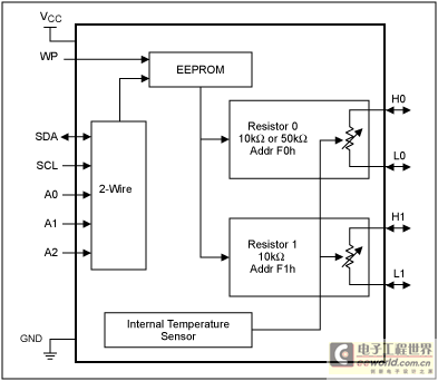

DS1847 Features
Figure 1 shows a block diagram of the DS1847. The DS1847 operates from a 3V or 5V supply over the temperature range of -40°C to +95°C and offers internal closed loop temperature compensation.
Figure 1. Block diagram.

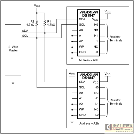

The DS1847 can operate standalone in closed loop mode without a microcontroller or with a microcontroller using an optional 2-wire master. The 2-wire master allows multiple devices to be controlled in different locations.
Figure 2 shows how multiple DS1847s can be connected to a 2-wire master. The address pins allow up to 8 devices on the 2-wire bus.
Figure 2. 2-Wire interface.

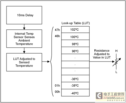

DS1847 Operation
The DS1847 has a LUT that determines the resistor value at a specific temperature (see Figure 3). First, after a 10ms conversion time, the internal temperature sensor senses the ambient temperature. This temperature determines the LUT address. If the temperature sensed is -38°C, the corresponding address is 01h. The resistance value in address location 01h is used to adjust the resistance.
Figure 3. Lookup table.

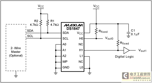

Figure 4 shows how the DS1847 can be connected to a fixed resistor to create a voltage divider (Vout0). This will provide a fixed or variable output voltage to an application over temperature. A transfer function can be programmed into the LUT to change the voltage with temperature.
Figure 4. Voltage and digital outputs.
The DS1847 can also be configured to create a digital output (Vout1). Using a fixed resistance of 4.7kΩ and the 50kΩ variable resistor, the output voltage range is 0.77V to 4.57V (see Example 1). The digital output can be used as an alarm or warning when the temperature reaches a certain value (see the Voltage Alarm Example). The digital output can be set to go low or high if the temperature changes from the set value or if the temperature exceeds a certain value.

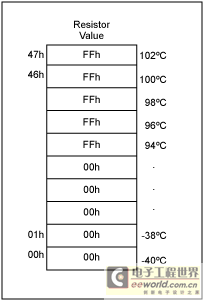

Voltage Alarm Examples
To set the voltage to go high when a specific temperature is reached, 94°C in this illustration (see Figure 5), the LUT would be programmed to set the resistor to the minimum position (position 0) for the temperature range -40°C to 92°C. For temperatures 94°C and above the resistor position would be set to FFh.
Figure 5. Lookup table for a voltage alarm.
