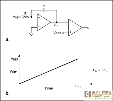

The simplest form of an integrating ADC uses a single-slope architecture (Figures 1a and 1b). Here, an unknown input voltage is integrated and the value compared against a known reference value. The time it takes for the integrator to trip the comparator is proportional to the unknown voltage (TINT/VIN). In this case, the known reference voltage must be stable and accurate to guarantee the accuracy of the measurement.
Figure 1a and 1b. Single-slope architecture.
One drawback to this approach is that the accuracy is also dependent on the tolerances of the integrator's R and C values. Thus in a production environment, slight differences in each component's value change the conversion result and make measurement repeatability quite difficult to attain. To overcome this sensitivity to the component values, the dual-slope integrating architecture is used.

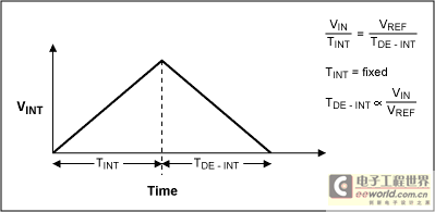

A dual-slope ADC (DS-ADC) integrates an unknown input voltage (VIN) for a fixed amount of time (TINT), then "de-integrates" (TDEINT) using a known reference voltage (VREF) for a variable amount of time (see Figure 2).
Figure 2. Dual-slope integration.
The key advantage of this architecture over the single-slope is that the final conversion result is insensitive to errors in the component values. That is, any error introduced by a component value during the integrate cycle will be cancelled out during the de-integrate phase. In equation form:
Vin × TINT = VREF × TDEINT
or
TDEINT = TINT × (VIN / VREF)
From this equation, we see that the de-integrate time is proportional to the ratio of VIN / VREF. A complete block diagram of a dual-slope converter is shown in Figure 3.

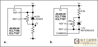

The integrating ADC needs more external components than the SAR. A SAR typically needs a couple bypass capacitors. The integrating ADC requires a good integrating and reference capacitors and also a low-drift integrating resistor. In addition, the reference voltage is often a non-standard value (like 100mV or 409.6mV) so a reference voltage divider circuit is often used.
