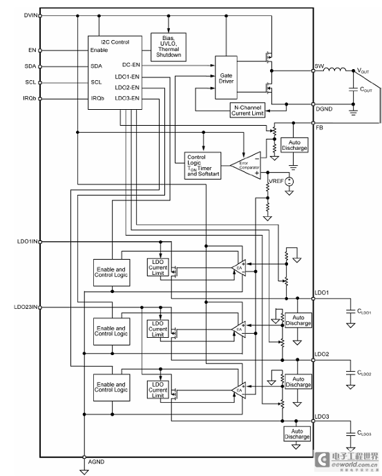

图1.MIC2826功能方框图

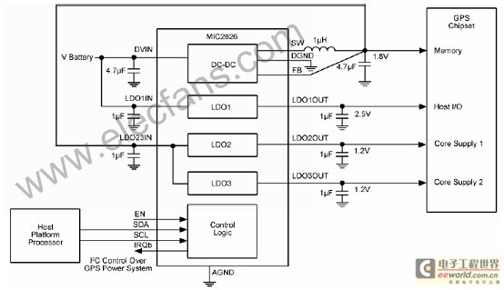

图2.MIC2826在GPS子系统的应用电路

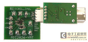

MIC2826 评估板
The MIC2826 evaluation kit includes:
• MIC2826 Evaluation Board
• CD-ROM including:
– MIC2826/7 Evaluation Software
– Evaluation User Guide
Third party hardware required:
• USB-to-I2C Interface Board (dongle)
• USB Peripheral Cable
图3.MIC2826 评估板外形图

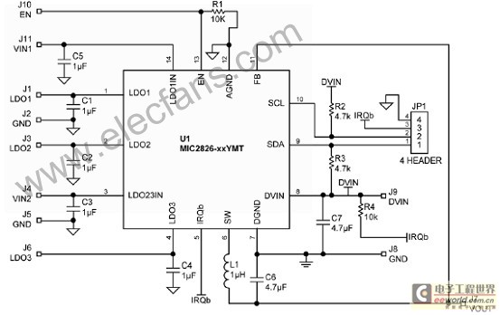

图4.MIC2826 评估板电路图
