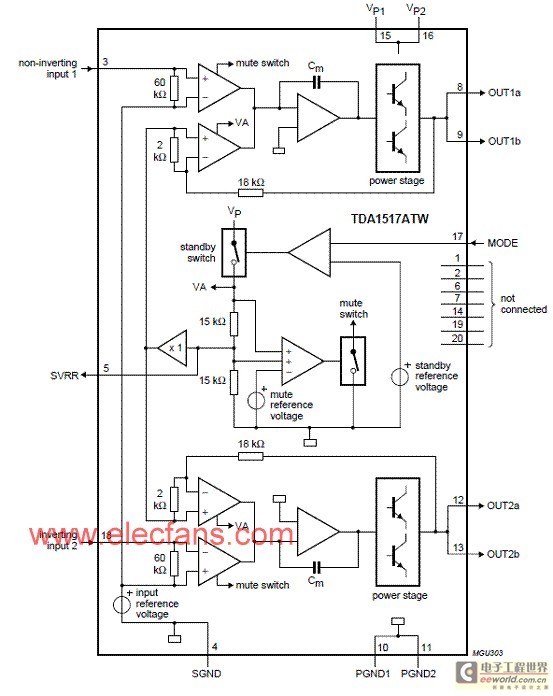

• Requires very few external components

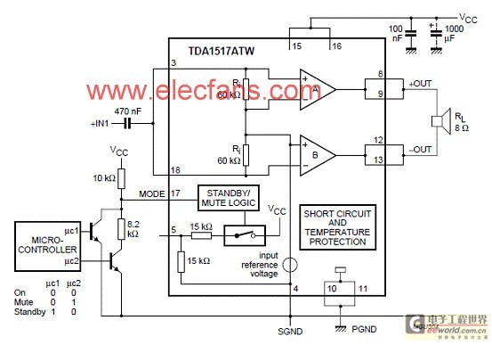

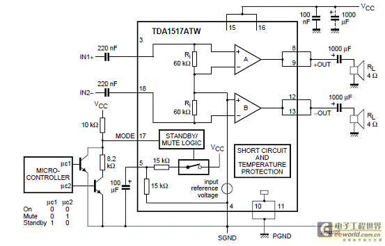

• Flexibility in use: mono Bridge-Tied Load (BTL) and stereo Single-Ended (SE); it should be noted that in stereo applications the outputs of both amplifiers are in opposite phase
• High output power
• Low offset voltage at output (important for BTL)
• Fixed gain
• Good ripple rejection
• Mode select switch (operating, mute and standby)
• AC and DC short-circuit safe to ground and VP
• Electrostatic discharge protection
• Thermal protection
• Reverse polarity safe
• Capable of handling high energy on outputs (VP = 0 V)
• No switch-on/switch-off plop
• Low thermal resistance.
图1。TDA1517ATW 方框图
图2。TDA1517ATW BTL 应用方框图
图3。TDA1517ATW SE 应用方框图
