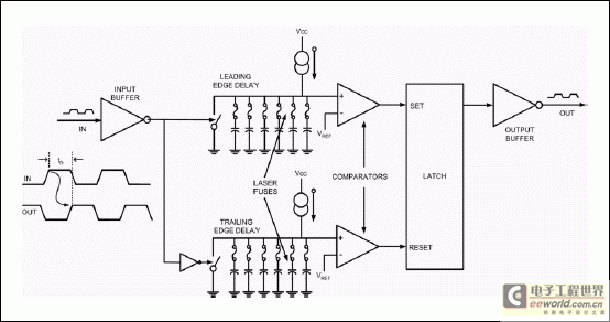

Old Generation DS1000 Delay Line.
The first Dallas delay lines consisted of a RC-based ramp generator and a comparator circuit that transitioned the delay line output when a certain voltage level of the ramp generator was reached. Calibration was performed at the factory at wafer level by using a laser to blow a series of fuses until the desired delay was achieved. There was no provision for temperature compensation.

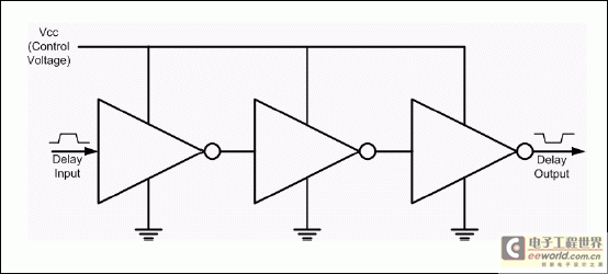

One way to do this is to use feedback, determine a delay error and use that error to generate a corrective input back into the delay line. This requires a method to measure the delay error and a way to control the delay time. A simple way to control the delay time in a logic gate is to vary the supply voltage. In general, the higher the voltage, the shorter the delay through the gate.
Figure 1. Voltage-controlled delay line (VCDL).

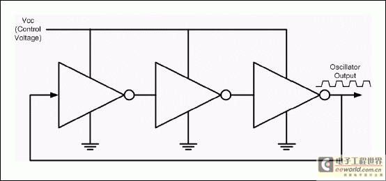

More work is required to measure the delay time and determine the delay error. The easiest method to the measure delay time is to convert it to something more easily measured, like frequency. If you take the output from delay line, invert it and feed it back into its input you have an oscillator with a frequency 1/2td, where td is the total delay through the delay lines. In this case, we have a voltage-controlled oscillator (VCO) based on a VCDL (Figure 2).
Figure 2. VCO based on a VCDL.

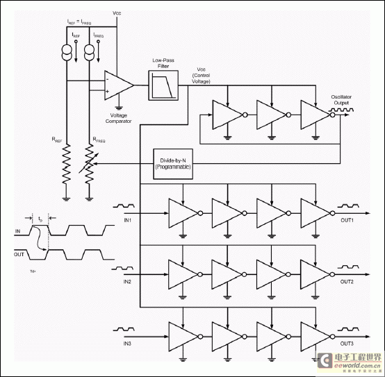

Given this, we have all the elements to build a compensated delay line. Figure 3 shows a block diagram for a DS1135 3-in-1 delay line.
Figure 3. Delay line (DS1135) based on delay-lock loop technology.
In the circuit (Figure 3), the oscillator output is fed back into a voltage-controlled resistance biased by a fixed current source. The controlled resistance is actually a switched capacitor circuit that has a DC resistance inversely proportional to the frequency of the feedback. As the frequency increases, the voltage drops. This voltage is compared to a fixed-voltage reference consisting of a matched current source and a fixed resistance (Rref). Rfreq is calibrated to match the characteristics of Rref over temperature and voltage. The output of the comparator is filtered and provides the VCO'fs drive voltage. As frequency increases, Vfreq decreases with respect to Vref, decreasing the drive voltage into the VCO, reducing the frequency. As the frequency decreases, the opposite happens, increasing the frequency. The stability of the frequency is equal to the stability of Rref. Rref is a precision reference that is stable over voltage and temperature and voltage. The control loop forces Rfreq to equal Rref. This control loop also negates changes in the delay portion of the circuit caused by variations in process, temperature, and voltage.
But this circuit alone cannot be used as a delay line. It does make a stable oscillator and is the circuit used in Dallas Semiconductors EconOscillators™. Fortunately, delay cells on the same piece of silicon, have nearly identical characteristics to the delay cell used in the VCO (Figure 3). The control voltage fed into the VCDL (configured as a VCO) has an identical effect on these other independent delay cells. So even though they are operating open loop, the control voltage applied to them has the same effect that is has on the delay cell configured in the VCO providing compensation for changes caused by process, temperature, and voltage.
