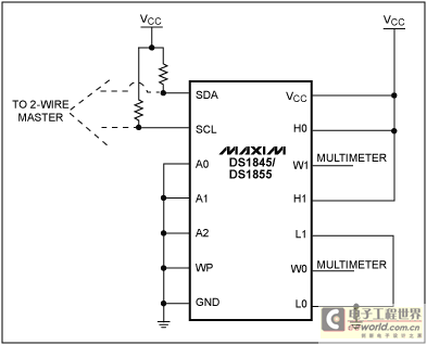

Voltage Divider Mode
To measure the temperature coefficient in voltage divider mode, the H terminal was tied to VCC and the L terminal was tied to ground. Using the 2-wire interface, the potentiometer position was changed and voltage was measured on the W terminal for each potentiometer position over temperature. See Figure 2 for a drawing of the DS1845/1855 in voltage divider mode. The equation used to calculate the temperature coefficient is below.
Equation 1.
Where,
ΔV = the difference between the voltage (V2 - V1) at temperatures T2 and T1 (T2 > T1), respectively
V1 = the voltage at T1
ΔT = T2 - T1

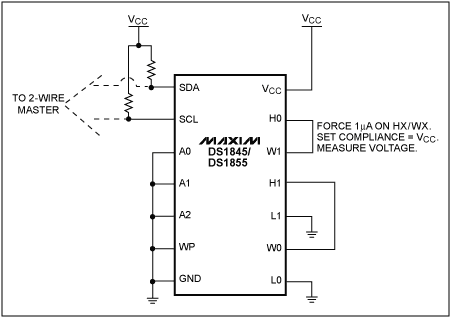

Variable Resistor Mode
To measure the temperature coefficient in variable resistor mode, the H and W terminals were tied together. The L terminal was grounded. A 1µA current was forced on the H and W terminals with the compliance set equal to VCC. Using the 2-wire interface, the potentiometer position was changed and the voltage was measured from W to ground. This measurement was repeated over temperature. Forcing a current and measuring a voltage ensures the biasing of the resistor terminal remains between VCC and ground. This ensures that the device parasitics do not affect the measurement. See Figure 3 for a diagram of the DS1845/1855 in variable resistor mode. The equation used to calculate the temperature coefficient is below.
Equation 2.
Where,
ΔR = the difference between the resistance (R2 - R1) at temperatures T2 and T1 (T2 > T1), respectively
R1 = the resistance at T1
ΔT = T2 - T1

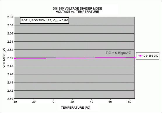

The temperature coefficient was calculated as approximately 10ppm/°C using Equation 1.
Figure 4. DS1855 in voltage divider mode (pot 1).
Figure 4 shows the voltage variation of the DS1855 in voltage divider mode over temperature. VCC was set to 5V; therefore at a 50% pot setting the voltage should be 2.5V.
The calculation below shows how the temperature coefficient for Figure 4 was calculated.
